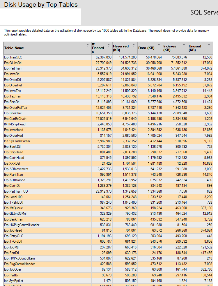

Here is a screen of our largest database tables. I believe that the large database size is caused by our setup where we use PCID tracking on a large number of parts. We manufacture at multiple locations, then transfer to 20 something stores where the parts are sold.
Your indexes look pretty large as well. What is your fragmentation like? Also noticed you have a UD on Part Tran…
The database fragmentation is really bad. I do have the tools in hand to get it cleaned up. So I’ll go take care of that and then reassess the situation.
The UD tables on PartTran are part of our Precise integration (Point of Sale software)
Fair enough…
