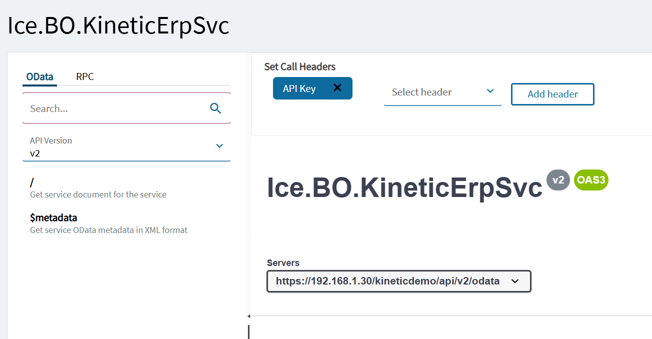

Strange, neither of the two endpoints seem to be accessible to me.
The API explorer lists the SVCs, but not the mentioned sub items under them. Only the SVC root / and $metadata seems to be available
When I try to GET Ice.BO.KineticErpSvc.GetUserSessionAndVersion a 404 is returned.
If you’re using v2 of the API then you must provide an API key. For testing, you can use the v1 - at least for the time being.
Try clicking on the RPC tab instead of the OData methods.
Thanks Mark, It was right there!
