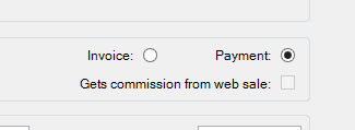

Go to
Sales Management \ Order Management \ Setup
Open Work Force
Select the Person
Set the Commission Paid at to Payment
I think the default is Invoice
From there you can use the Commission report in Accounts Receivable
