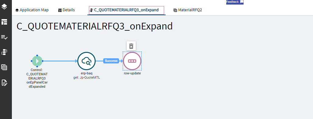

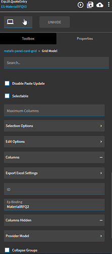

I have to recreate a panel card grid tied to a BAQ that has parameters on it. I was advised not to add the BAQ through the grid model>provider model, because we wanted the panel card to pull information related to that specific quote. So instead I believe it uses parameters from the BAQ?

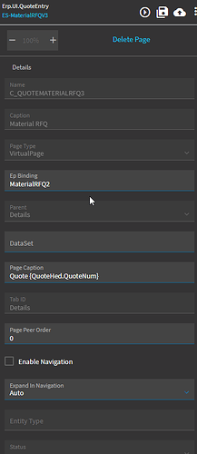

I cannot get the new panel card grid to show results of the BAQ. Our original panel card works, but it is interfering with other UI customizations we have in place with the 2023.2 release. I added the data view and then entered that into EP Binding. Anything other suggestions? Desperate to get this fixed before we move to 2023.2.
