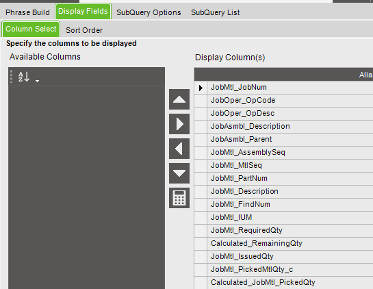

I started editing a BAQ this morning, saved, went back in, and now it has nothing showing in the phrase build screen. However, the General tab still shows the query phrase and the Display Fields still shows selected columns.

can you share a screen capture of the phrase builder?
Are the boxes there?
It was completely empty.
I appear to have been able to solve this by stopping the Memory Cache of the Business Activity Query Designer.
