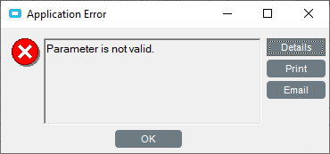

Parameter is not valid
I have been getting this here and there lately, first with a dashboard, then in BAQ designer.
Anyone else?
(I failed to grab the details before I closed it.)
Ah, it was when trying to “Copy to Excel.”
Error details
Application Error
Exception caught in: System.Drawing
Error Detail
Message: Parameter is not valid.
Program: System.Drawing.dll
Method: GetHdc
Client Stack Trace
at System.Drawing.Graphics.GetHdc()
at Infragistics.Win.UltraWinGrid.ExcelExport.UltraGridExcelExporter…ctor()
at Ice.Lib.Framework.EpiUltraGridExcelExporter.ExportToExcel(EpiUltraGrid grid)
at Ice.Lib.Framework.EpiContextToolsManager.handleToolClick(ContextToolClickedEventArgs e)
at Ice.Lib.Framework.EpiContextToolsManager.OnToolClick(Object sender, ContextToolClickedEventArgs e)
at Ice.Lib.Framework.PopupMenuBuilderBase.ToolbarManager_ToolClick(Object sender, ToolClickEventArgs e)
at Infragistics.Win.UltraWinToolbars.UltraToolbarsManager.OnToolClick(ToolClickEventArgs e)
at Infragistics.Win.UltraWinToolbars.UltraToolbarsManager.FireEvent(ToolbarEventIds id, EventArgs e)
at Infragistics.Win.UltraWinToolbars.ToolBase.OnToolClick()
at Infragistics.Win.UltraWinToolbars.ToolMenuItem.OnClick()
at Infragistics.Win.UltraWinToolbars.PopupMenuItemUIElement.DoClickProcessing(MouseEventArgs e)
at Infragistics.Win.UltraWinToolbars.PopupMenuItemUIElement.OnMouseUp(MouseEventArgs e)
at Infragistics.Win.TextUIElementBase.OnMouseUp(MouseEventArgs e)
at Infragistics.Win.ControlUIElementBase.ProcessMouseUpHelper(Object sender, MouseEventArgs e)
at Infragistics.Win.ControlUIElementBase.ProcessMouseUp(Object sender, MouseEventArgs e)
at Infragistics.Win.Utilities.ProcessEvent(Control control, ProcessEvent eventToProcess, EventArgs e)
at Infragistics.Win.UltraWinToolbars.PopupControlBase.OnMouseUp(MouseEventArgs e)
at System.Windows.Forms.Control.WmMouseUp(Message& m, MouseButtons button, Int32 clicks)
at System.Windows.Forms.Control.WndProc(Message& m)
at System.Windows.Forms.Control.ControlNativeWindow.OnMessage(Message& m)
at System.Windows.Forms.Control.ControlNativeWindow.WndProc(Message& m)
at System.Windows.Forms.NativeWindow.Callback(IntPtr hWnd, Int32 msg, IntPtr wparam, IntPtr lparam)
Seems the issue might be related to Infragistics UltraGrid when trying to launch and render an instance of Excel. Memory is not enough.

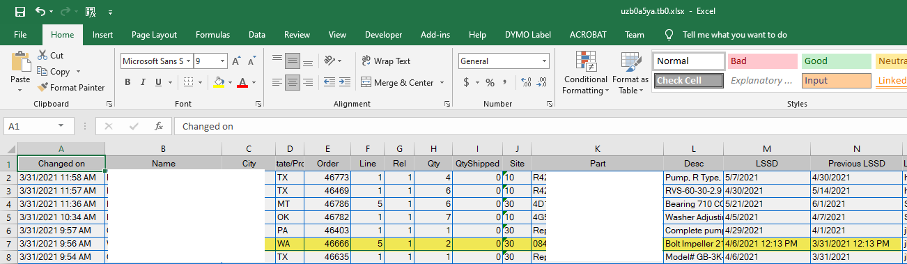

Probably unrelated, but the Copy To Excel seems to include the styling and formatting of the source grid. So there could be a lot more info than just the values of the cells being moved around. If you were to select all Rows and then use “Copy All Include Labels”, you could paste that into a blank Excel file.

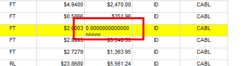

Some of my SSR reports that are rendered to an Excel file, give me an error like:
Selecting OK allows the file to load, and I find a cell like:
That row is normally highlighted yellow, because the QOH is zero. It’s the fact that the cell shows up
as the string: 0.000000000000000000.
If whatever is generating the excel file when “Copy To Excel” is used, works similar to the SSRS rendering for Excel, it could be choking on some data. Especially formatting/styling, as the errror is in the “Drawing.dll” program.
