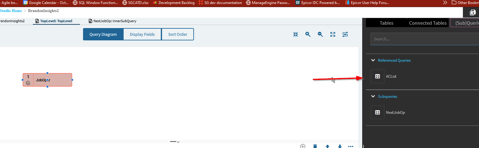

You can now use BAQ’s as sub queries for other BAQ’s. I haven’t messed with it much yet, but it has the potential to be pretty powerful.
Is this in version 10?
Ah, sorry, this is Kinetic. Gotta upgrade!
