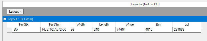

I am trying to figure out how this works, so I created an example to work with. This example is creating two tables in a parent/child relationship in a dataset and binding the dataset to an EpiUltraGrid. I am using ExpandAll on the grid. But I only see the parent table in the grid. (I know UD102 and UD102A are already setup in a parent/child relationship, but I wanted to test this from any two tables. I’m just using UD102 and UD102A to populate the tables)
Why is the child data not showing up in the grid?

//Add the dataset as the datasource for the grid
LayoutsGrid.DataSource = UD102DS;
LayoutsGrid.DisplayLayout.ViewStyle = Infragistics.Win.UltraWinGrid.ViewStyle.MultiBand;
LayoutsGrid.DisplayLayout.ViewStyleBand = ViewStyleBand.OutlookGroupBy;
LayoutsGrid.DisplayLayout.Bands[0].SortedColumns.Add("Layout", false, true);
LayoutsGrid.Rows.ExpandAll(true);
