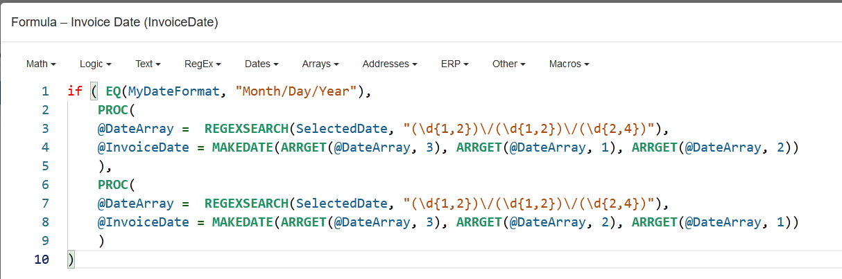

I already made a formula to be able to flip DD/MM/YYYY and MM/DD/YYYY, then am mapping the format that each vendor uses to the convert to our standard date format. That part is working great.
So, the next part of this journey is to look at the next of the 34,985 different ways to format a date and get that to convert.

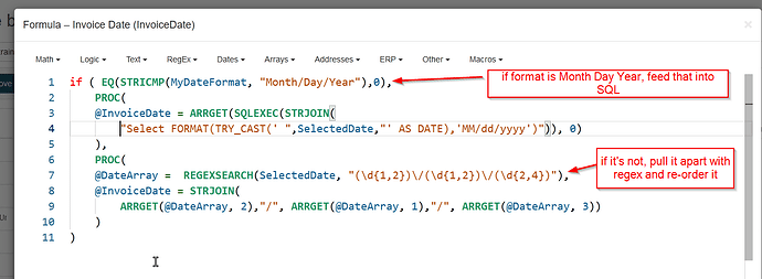

This is the formula that I have in place to handle the day and month flipping around with different formats.
But is there a way to do this for other date formats without having to explicitly handle each possible variation?

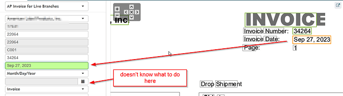

side note: when I tried to just use the string of the “selected date” as a result instead of using MakeDate(), which theoretically would work for most of the invoices, the validation was failing saying that they didn’t match. Which I’m assuming has to do with the type on the field. But I can’t let the “selected date” be set as a date, but the format fails if it doesn’t match… I couldn’t find a way to just convert the text to a date without pulling it apart using regex.

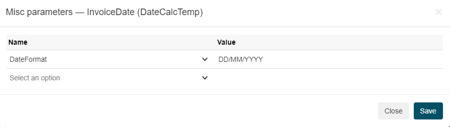

In the EU I picked these date formats.

So want I ended up doing was adding a date format drop down. Then this value is mapped to the vendor name, because the vendor will always (or at least usually) have the same date format. So if they run across a vendor that does it day/month/year, the user just selects the date format for that one, then that is mapped to the vendor, and the next time that vendor shows up, it’s automatically switched.
For the normal format, or if someone uses words, I execute SQL because sql will take a bunch of formats, and then I can take the response from SQL and shove that into a string with the correct format going forward.
DateFormat
I think this should work nicely. I wish it wasn’t so hacky, but I had a call with and IDC guy today, and he said that this was pretty clever, and that they didn’t have any built in functions to do what I’m doing, so I’ll use this I guess.

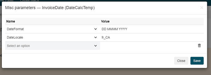

The date locale can be changed on version 9.34, I usually create a vendorname dependant version then change the locale for the vendor.
Does it export them in the date locale chosen? Or a translate them to a standard? I would be awesome if it translated the different date types to standard for export so that ECM could read them appropriately.
Translates to the standard format. The locale indicates how the date is formatted and when converted to the IDC format will just be a date.
I tested this on French months and it converted to a regular US date format.
It’s a misc parameter called DateLocale and DateFormat.
When changing the format, you need to know the Date Locale of the batch type and the date locale of the vendor. The date format will be dependant on the locale but I did not have to change the locale if the date format is DD/MM/YYYY to MM/DD/YYYY.
