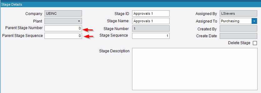

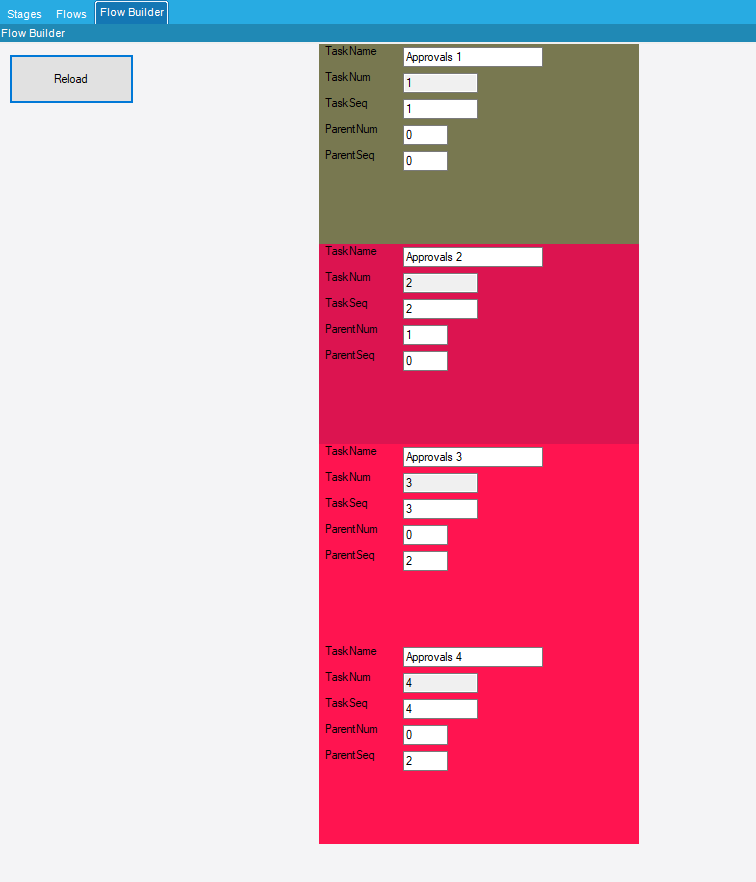

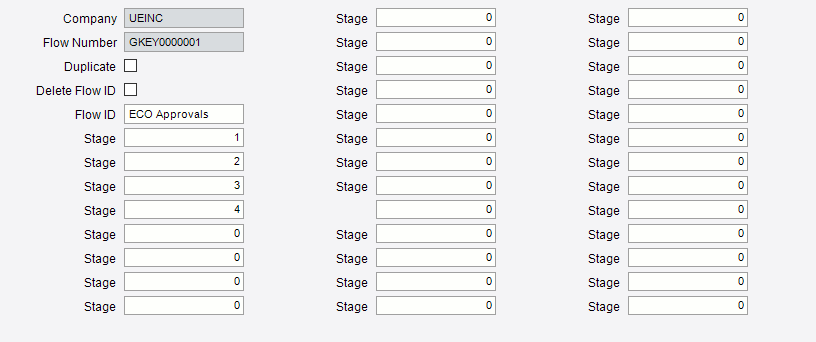

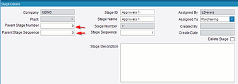

It was an attempt to build a workflow builder where you could have various dependencies for a single task. With a draggable UI to rearrange tasks. It technically works (not happy with the layout builder) but the original requirement for it kind of evaporated as positions changed and focuses shifted.
I have a few other screens for the end user to configure specifics per task per copy of the flow. And then one for the end user to complete said tasks. Kind of a Setup / Management / Entry hierarchy
