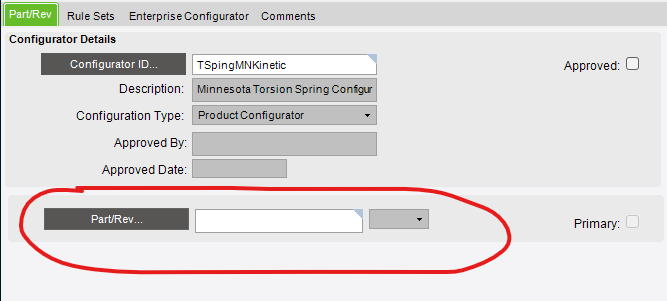

Hi all, I have read previous threads on this topic but find myself stuck on what I think is a relatively easy fix, but I’m without my previous technical resources. I’ve made a copy of the part configurator, exported, and reimported as a new configurator for testing. I’ve created a test part to link to the new configurator, but for the life of me I can’t figure out how to link the configurator rule to the part number. I believe its here, but I can’t manually enter the test part and nothing populates when I search. I’m sure I’m missing something very obvious but I haven’t messed with our configurators since go live over 2 years ago.
Any help is greatly appreciated.

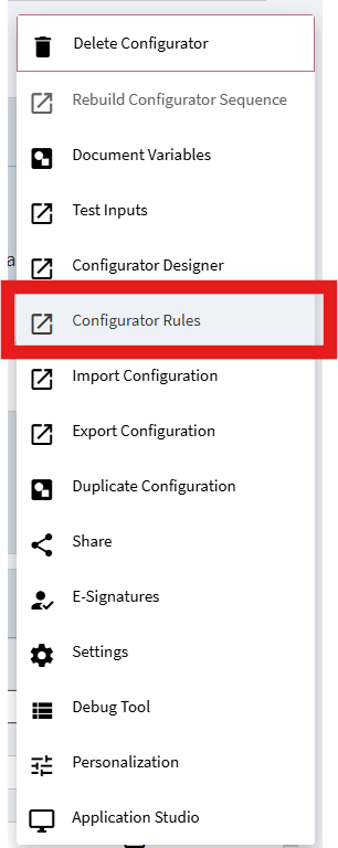

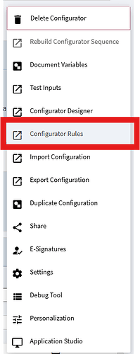

If I understand your question correctly, I think you’re after. (This is in the overflow menu of the configurator entry)
Go the opposite direction. Make sure your part has an unapproved revision and add the configurator ID to the revision record. Should be searchable/findable in configuration rules after that.
Thank you! This worked. I knew it was something straightforward.

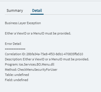

I think I have the configurator setup correctly and I can preview it in application studio, but when I try to configure of an SO it says I need a view or menu id.
Do I need to actually create a menu id linked to this base layer and then provide security to it in order for it to work correctly?
Sorry for the real time updates as I work through this. Hopefully its helpful for anyone else working through this or who will be soon.
I’ve added a menu id for the base layer and that works. Code on the configurator says its okay.
