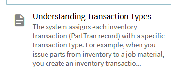

There is a help article that lists all the transaction types - you are probably better off looking at that to make sure you look all the relevant transactions. There are shipments form stock, direct shipments, kit shipments, etc.

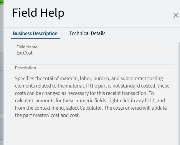

Thank you for your help. Would this be the ExtCost? I started with SUM(PartTran.ExtCost) / NULLIF(SUM(PartTran.TranQty),0)
but the results aren’t close to the unit cost in OrderDtl tables
