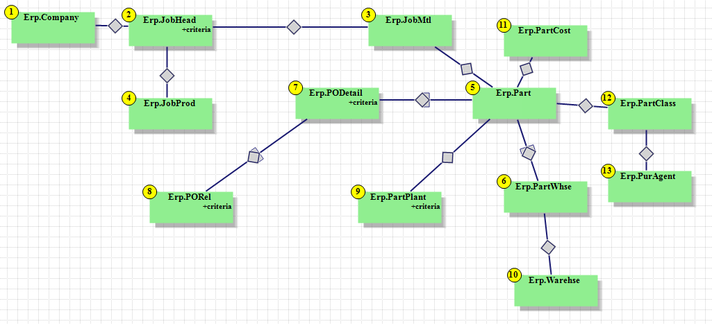

Like @Asz0ka said, there’s probably some join that is causing a duplicate value in your query, which is doubling your aggregate SUM function. Could you share a screencap of the BAQ, and maybe the SQL code on the front page of the query?
This is from the Phrase Build
The SQL query

If something in the query is causing duplication, can you think of a reason why it won’t affect all the parts alike?
Could be a number of things, multiple cost groups, part wharehouses, etc.

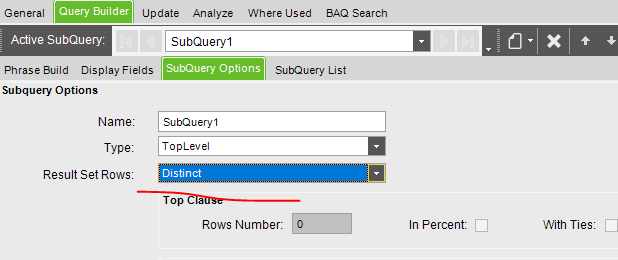

You could just try setting that base query to “distinct” and see if that fixes it
It could be that whatever join is causing the duplication has only one row for some parts. For example, you have Part and PartCost joined on the PartNum. If some parts have mutliple CostIDs, then those would duplicate (and double) but Parts with only 1 costID would not.
I would say your best bet for troubleshooting would be to make a copy of your query, and delete some tables that might have a One-To-Many relationship one at a time, with testing in between. I’m not sure about the relationship between PartClass and PurAgent, but I’d probably try that one, PartWhse & Warehse, and PartCost to see if removing any of those eliminate the issue.

So, I tried multiple things with my BAQ removing and adding some of the tables you mentioned. It did not work. Then I rebuilt the exact same query in the Test environment and the doubling up issue is gone. I have the same query in the Live environment but the numbers double up. I can’t figure out why though? I checked the cost ID, there is only one. And the strange thing is that the parts that are showing double the demand and quantity are only set up in one warehouse. There are other parts that are set up and have demand + qty spread across multiple warehouses, but they add up just fine.
Update: I got it to work using a subquery. I created the calculate fields inside the subquery and then included them in the display fields in my main query which fixed the doubling up issue.
