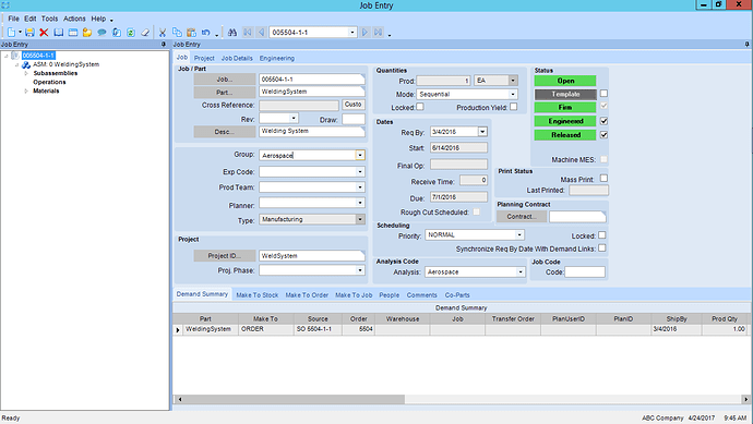

As Kimberly mentioned, you can use the Header/ASM analysis code. This means
that for each Job produced, Epicor will auto fill in the Header Analysis
code (from part maintenance) so you can see the “mix” of jobs on the floor
at anytime or, historically, the grouping of jobs you produced based on
that analysis code (See below for example of a job where either the Product
Group and/or Header Analysis code can populate with “Aerospace”
