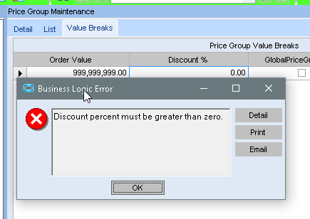

But setting one up with a Discount of zero yields:
:frowning:

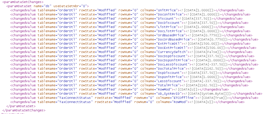

A change to an order line (like Qty or unit price) fires SalesOrder.MasterUpdate(), with:
Maybe intercept the MO method and tweak the Disc fields based on checking a parameter of the part (UD field or belongs to a specific group, etc…)

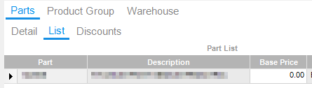

Then setting up the specific part I don’t want to have the discount (same price list):

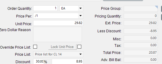

On a sales order, you get the discount for a part that wasn’t defined on the price list, but is part of the product group:

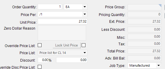

But the one I defined on the part tab:
As you can see, the 30% did not go to the part that I defined. This may not be applicable to your case, but I’ve found it useful if we have parts that we don’t want to discount that are in the same product group.
