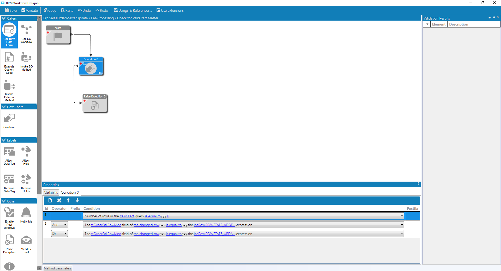

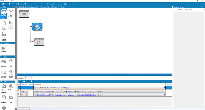

Hello,
Any one able to help me with this BPM?
It’s enabled but when a sales order is updated with a invalid part, it’s saved without any problems… :confused:

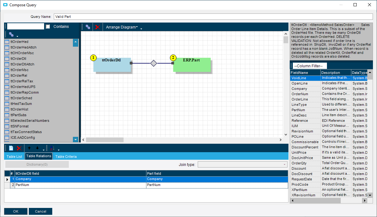

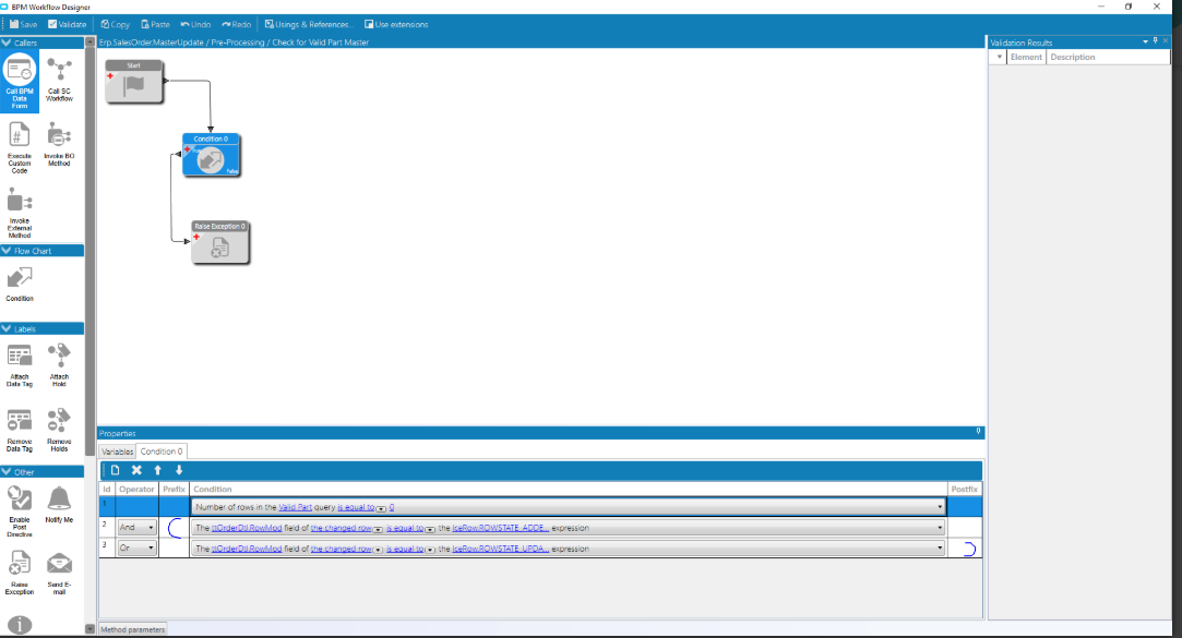

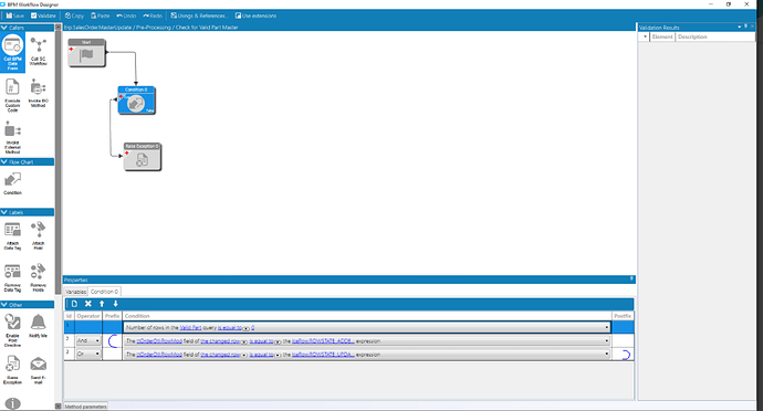

Try grouping the last two conditions.
With open and closed brackets. I have added in the below screen shot.
Change your condition, there should be one that says “there is atleast 1 changed row” it’ll handle both add/update for you.
Or add parenthesis to your current one.
Hi Hasokeric,
The solution above is working perfectly fine but we have the lines come in from the API; if a unknown part is found it’s highlighted but you can still save the order but if you add a new line where the part isn’t found it wont let you save it?

I didn’t want you to continue that trend of adding an expression where you didn’t need one, so the next 20 BPMs can benefit :smiley: hehe #JustABestPracticeSuggestion
