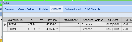

With the Acct on the PORel set to 6130-00-01 (SMALL TOOLS), the TranGLC (for PO 48924) shows:

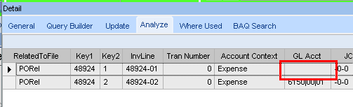

Clearing that acct# on the PO entry (and saving), sets the description of the GL Acct (which is blank) to “Sales Expense”:
The BAQ shows:

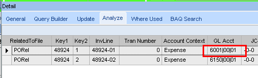

Pressing the “Get Default” button on the PO Rel, populates it with the expense acct defined in the Company GLC.
And now the TranGLC show:
