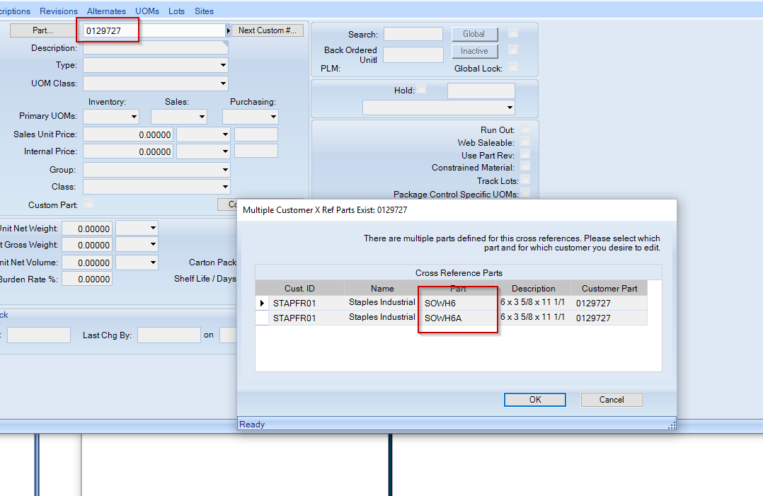

I’ve contacted support about this and the official response was it ever working was a bug and they don’t truly support it because it’s a one to many relationship. I built a series of customization to fill the gap. Attached is a solution for those.
Provided without any warranty, guarantee of function or free from malicious code. safe harbor! safe harbor!

I thought I would piggy back on this issue with a further enhancement.
I have added a Pre-Processing Methods Directive to Part.GetPartXRefInfo.
I call it Job Number Lookup Feature:
In my case my production jobs have a “V” prefix, my manufactured parts don’t.
So the Methods Condition is "the PartNum argument begins with “V”.
I synchronously run ABL code.
Define Var sScCheck as Character no-Undo.
MyCheck = ‘Not Sure’.
find JobHead Where JobHead.Company = Cur-Comp
and JobHead.JobNum = PartNum no-lock.
if JobHead.Jobnum = PartNum then MyCheck = ‘JobNumber’.
IF MyCheck = ‘JobNumber’ then PartNum = JobHead.PartNum.
OK so now what.
You can enter a production job number in the part number field and it will look up the manufactured part for you.
