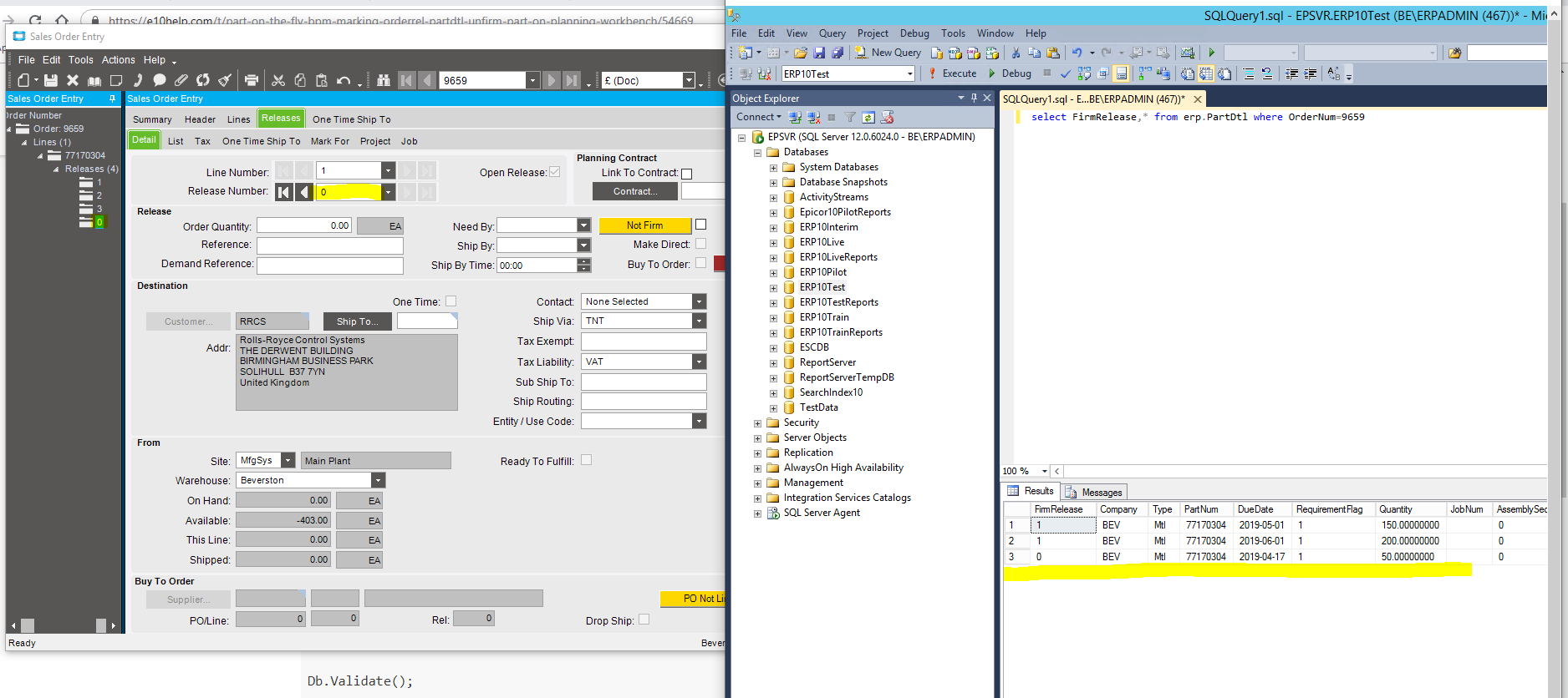

A query shows that it does set both OrderRel.FirmRelease and PartDtl.FirmRelease to false.
But when I run MRP and then Planning Workbench I get suggestions for POTF parts.
If I go into the order and cycle FirmRelease on and back to off, run MRP and then PWB, the suggestion is gone.
I have one development environment where this tests okay, but all the others do not. All on 10.2.200.18.
I tried a standard transaction and the sales order BO in code to set OrderRel.FirmRelease (RowMod = “U”) to false and then update. It did set OrderRel.FirmRelease to false but it did not set PartDtl.FirmRelease to false.
What other setting am I missing that MRP would be looking at? Maybe a different tack?
