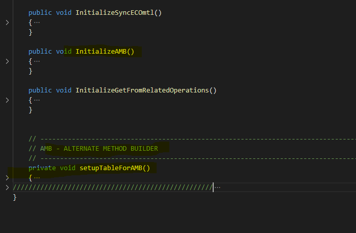

I’ll walk you through it as I do it. On Part Revision, click button and add revision’s site to lower materials recursively. Just whipped up this query. Going to grab all mtls related to revision and add site/plant one by one.
select p.Company, p.PartNum, pp.Plant from Erp.PartRev pr
inner join Erp.PartMtl pm on pm.RevisionNum = pr.RevisionNum
inner join Erp.Part p on p.PartNum = pm.MtlPartNum
inner join Erp.PartPlant pp on pp.PartNum = pm.MtlPartNum
where pr.PartNum = 'wagonwheel'
and pr.Company = '01800000'
and pm.Company = '01800000'
and p.Company = '01800000'
and pp.Company = '01800000'
