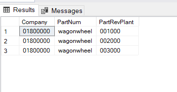

select p.Company, p.PartNum, pp.plant as PartRevPlant from ERp.Part p
inner join Erp.PartPlant pp on p.PartNum = pp.PartNum
where p.PartNum = 'wagonwheel' and p.Company = '01800000'
Why is this pulling back all available Part Plants and not just ones assigned?

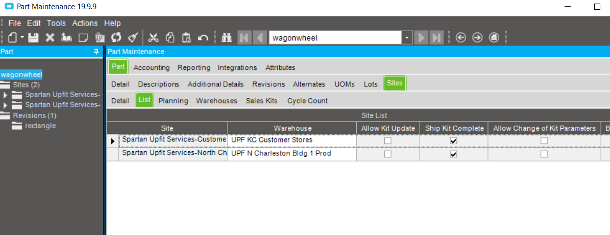

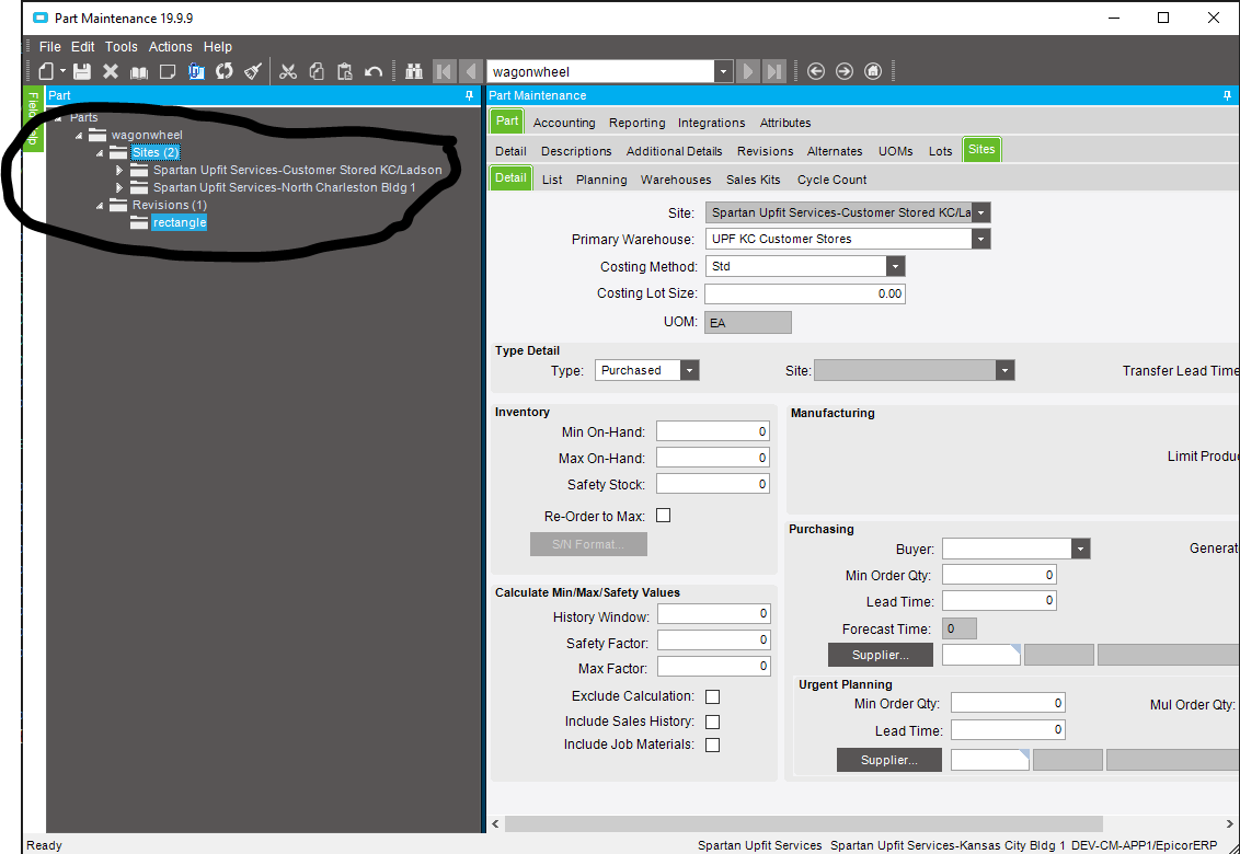

If you go to part entry for that part number, which sites do you see there?
Its pulling in more because in your join you are not joining on the Company.
However, I don’t think that is what you want… You might be more interested in your scenario with the Site: drop-down on the Revision Tab (which is different than PartPlant).

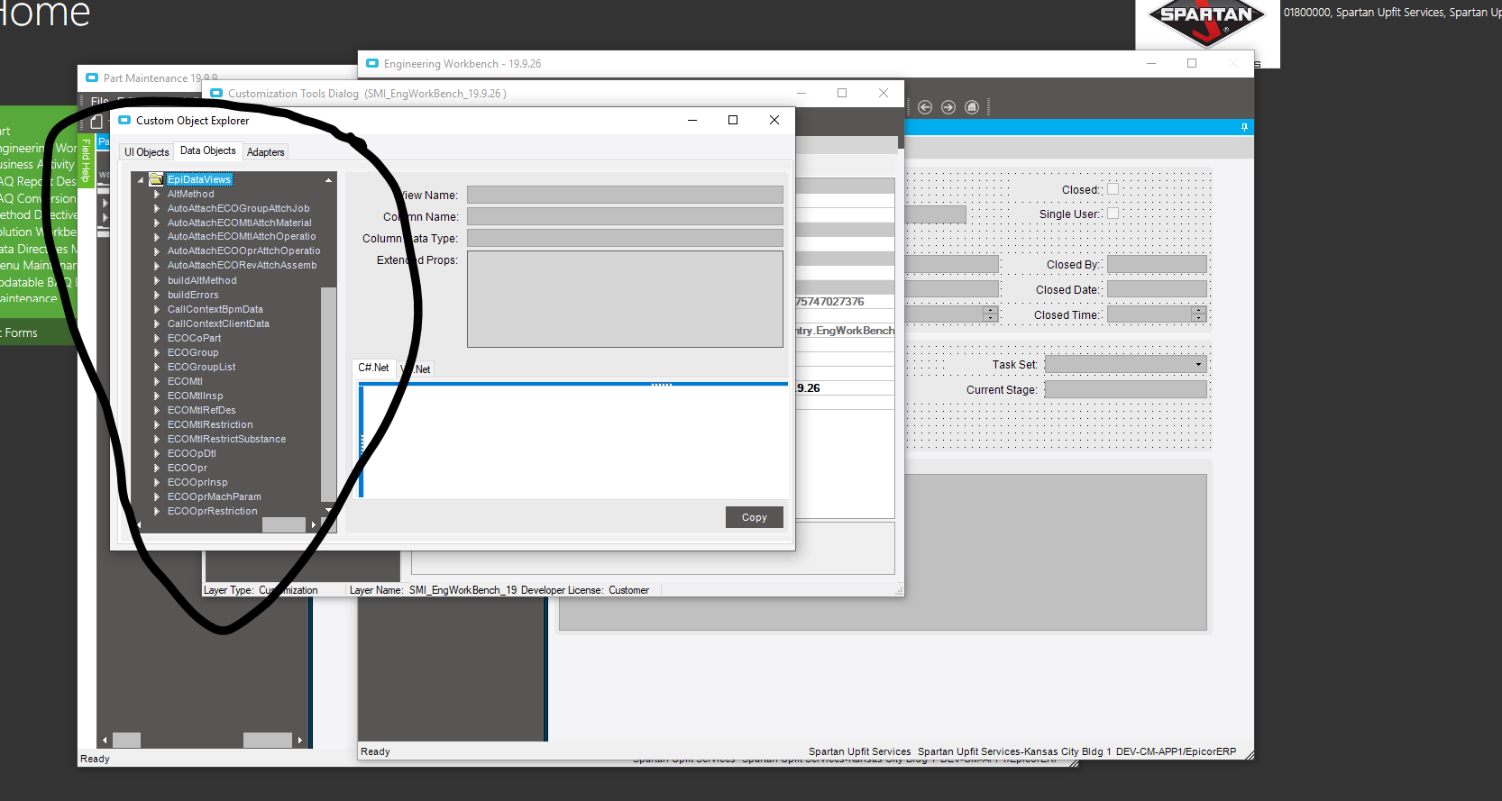

Hmmmmmm I’m going to have to figure out how to grab it from the screen in Epicor. Where can I find a list of options for EpiDataView’s
Check the object explorer.
I found them
thank you!
I need to grab these two plants somehow based on the partnum
@josecgomez I was trying to extract and get the data through an EpiDataView (ECORev)
