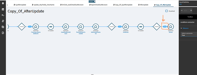

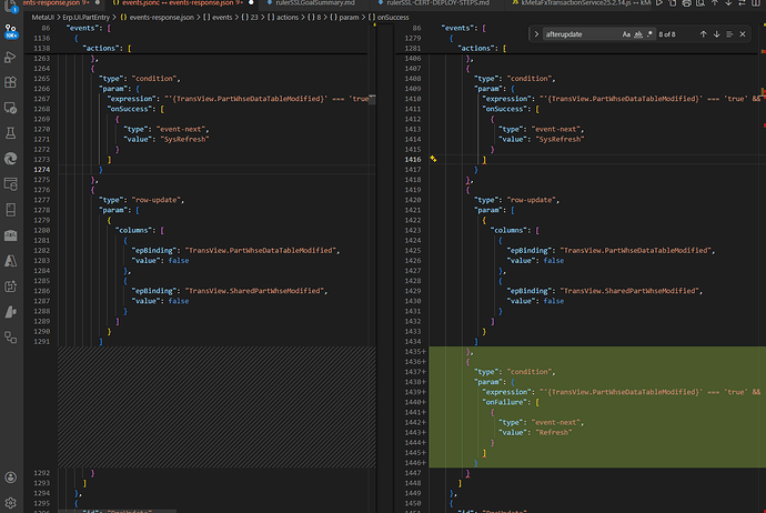

Looks like in AfterUpdate event they added a condition > event-next > Refresh.
Overrided and disable in a layer the problem goes away.
I just changed this from false to true and the prob went away. :man_shrugging:
Safe Harbor: this is just a quick compare to an old version so could be wrong but this refresh is added recently is all I can say.
