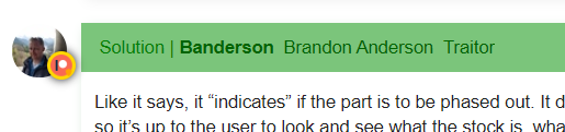

Like it says, it “indicates” if the part is to be phased out. It doesn’t have any logic to actually do anything, so it’s up to the user to look and see what the stock is, what the requirements are and make a decision as to what they will do. It sounds like such a simple thing (“Just use these up”) but there are so many factors and scenarios that have to be covered, that Epicor simply cannot make it work out right. So they leave it up to the business.

And I am dying at the “Traitor” badge for Brandon. (Honestly best of luck to you, though.)
