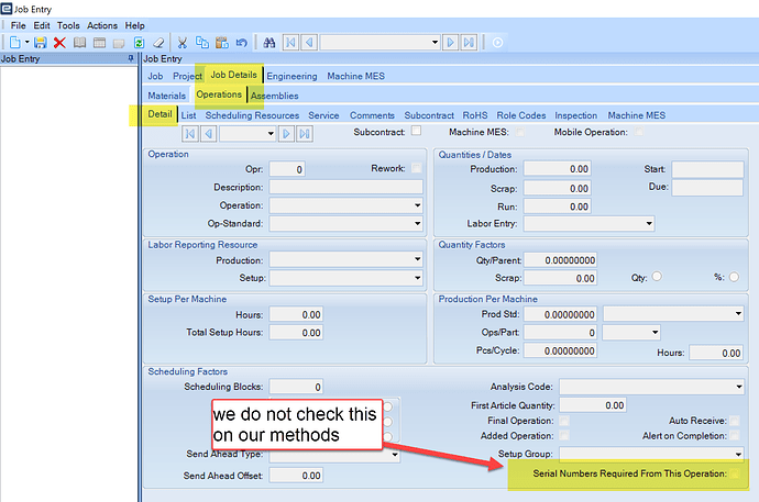

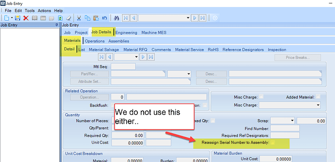

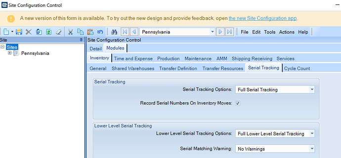

My question is, why does Epicor ask me to select the serial number again when receiving to inventory, when I have already selected it when the operation was completed?
Or is the serialization done at the operation level, and then when receiving only those serial numbers that were selected when the operation was completed show up?
Do I even need to set the operation as requiring a serial number? Can I just assign the generated serial numbers to the job and then select them when receiving to inventory?
