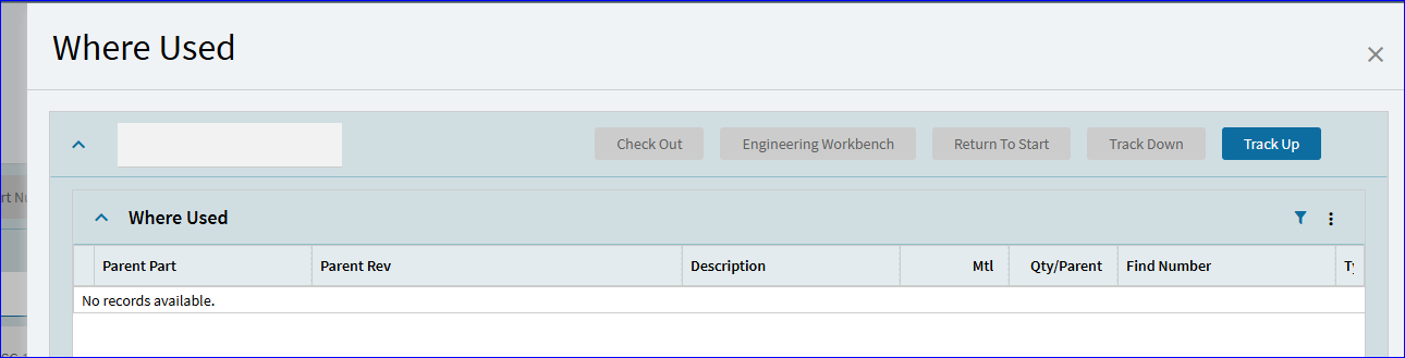

End users have discovered that the “Track Up” feature, when using “Where Used” on a part, doesn’t work in Part Tracker but functions correctly in the Part screen.
Is it feasible to enable this feature in Part Tracker?

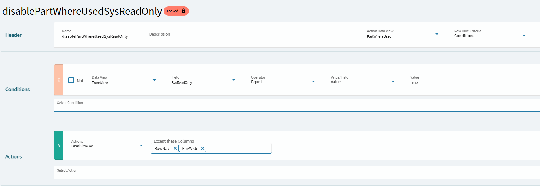

There is a base (uneditable) row-rule that, disables all fields in the PartWhereUsed dataview except RowNav and EngWkb when in “tracker mode”.

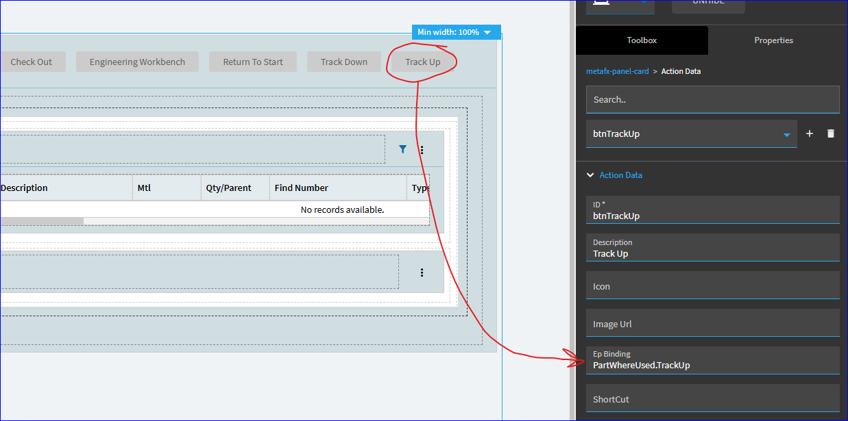

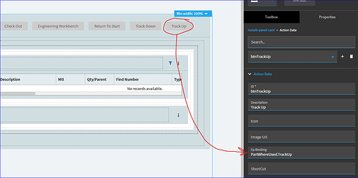

All the Where Used buttons are bound to the PartWhereUsed dataview, and therefore also disabled.
One easy solution would be to reassign (or delete all together) the bindings of those buttons away from the PartWhereUsed dataview. Then that row-rule won’t affect them.
So, I tested by deleting the binding on the tool. Success. Now it wasn’t disabled.

Instead, you COULD just blatantly circumvent the row-rule.
Remember that the Condition where the rule takes effect is when TransView.SysReadOnly = true.
So… just set it to false!

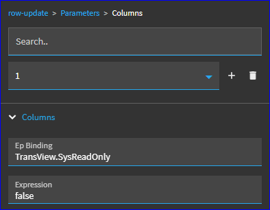

First Event… We don’t want to change this value/setting unless someone navigates to the Where Used page. So, before the GetWhereUsed event (before the slider opens)… row update TransView.SysReadOnly to false.
This worked!

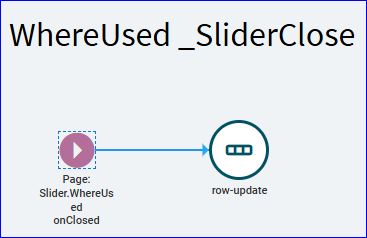

BUT… it set the entire Part Entry form to read only = false… so when you close the Where Used slideout, everything is now active (as if you were in Part Entry now and not Part Tracker). So, going this route also requires an event to change TransView.SysReadOnly back to “true” when you close the Where Used slideout:

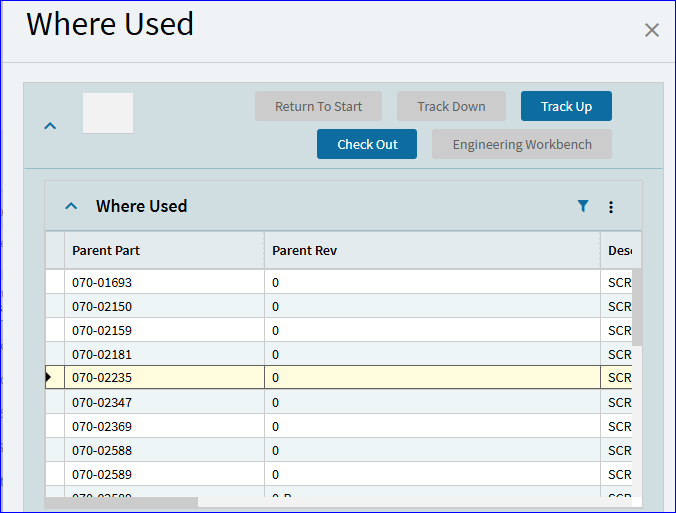

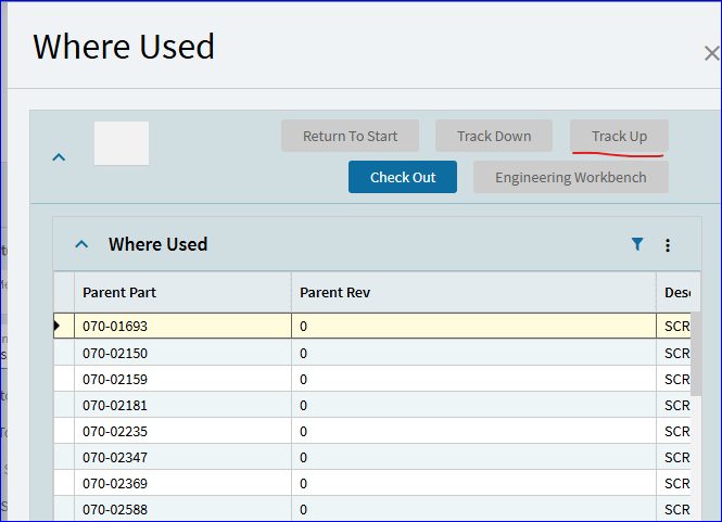

Works… but keep in mind it not only turns the track up/down functionality on, it also opens up the Check Out button and potentially other things.
But here is a part without a Parent… notice the TrackUp is still disabled.
If I choose a part from the list the does have a Parent… Track Up is now available.
