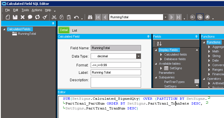

While working on a Running Total in a PartTran BAQ,
I ended up using a subquery to set the “signs” of the tran qtys (e.g. 1,0 or -1)
Then a running total calc field in the main query that sorted records by TranDate and TranNum, both in descenging order & that (finally) started matching up with the PartTranHistTracker.
