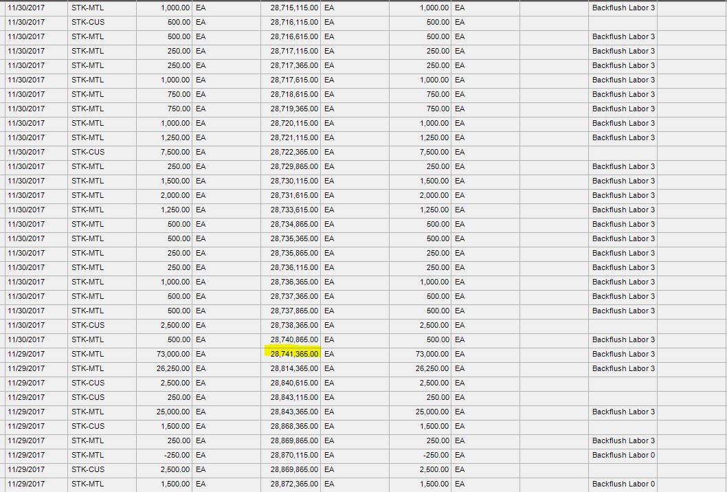

Hi Ho, Hi Ho its Monthly Inventory time to go!!! And we have a part that on 11/29 the last entry showed a quantity of 28,741,365.00. Yet on 11/30 at 8:29 AM we have a whopping total of 28,804,365. And we had nothing added to this, in fact all we had all day was subtraction.
So, first, I think internally we need to reassess how and when we do inventory. But for the Epicor Question, why would it be off by so much? I did a part refresh on Monday so it should be good. Thoughts.

So my snap shot at 4pm on 11/29 is 28,804,365 but my part transaction history is 28,741,365. About 80K off. I’m assuming Part Trans can be a little off at times, but is this much variance normal.

While I cannot see the full history for 11/29 in your screen shot, I would assume that at the time the count was started the inventory in the warehouse (not all warehouses, make sure your Transaction history is only looking at the warehouse being counted) was 28,804,365, but I can’t see if there are other transactions that day, nor do you have the transaction time in your screenshot (might need to do a BAQ on PartTran to get that. (there is a SysTime and a TranTime, you might want to look at both).
