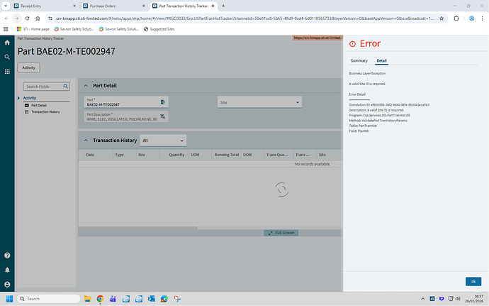

We have just upgraded live to 2025.2.6 (We did test this previously and had no issue) and some users are reporting that when they access PTHT they are getting an error and the Site is missing. When they click OK, the screen just looks like it wants to refresh but it doesnt! Anyone seen anything similar?

I think i may have found a workaround in that i removed the site in question from the user and added them to another site. Then removed that site and added the original site back in. Two of the users that reported the issue are now working fine! Not really something that i want to have to do on all users and certainly not a workaround that will work if you only have one site.
