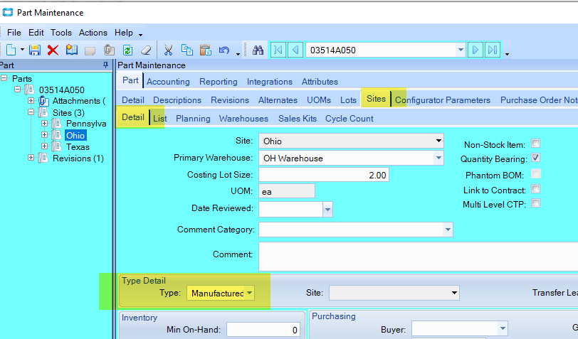

Check that the manufactured part is set as part type mfg on the part site record.

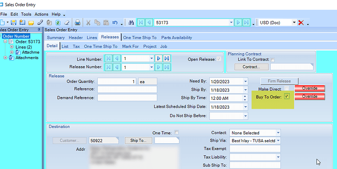

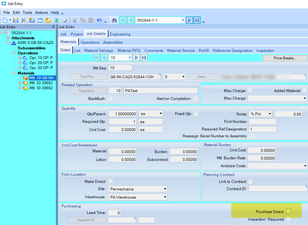

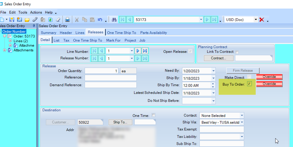

Make sure that your part / site tab is set for manufactured (1st screenshot), not just the front page part detail. After that, the demand will determine how the part is going to get fulfilled. Is there any chance the part is being used on a job and someone put it as job material and checked purchase direct (second screenshot) on it? Any chance someone checked buy to order on sales order release (3rd screenshot)?

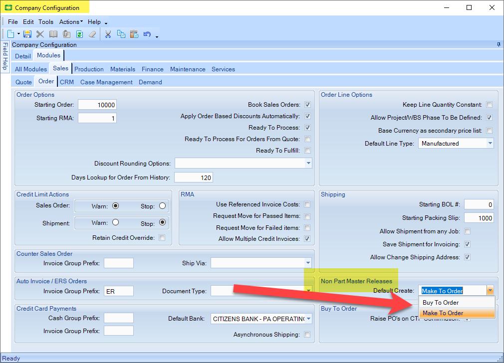

If it is a part on the fly, there is a setting in company configuration to set the default sales order line type. If it’s purchased and the part isn’t setup in the part master, any new sales order line would default to a purchase order suggestion.

I haven’t used this because we default to make, but how about this?

We have both the “Manufactured” option on the top and the “Make to Order” that you have highlighted. I’ve never seen this setup generate a purchase order though. MRP hasn’t been able to create the job because there isn’t a method, but it always showed up in the planning workbench as a “new” demand.
