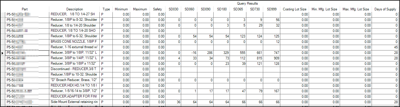

Here is one I have for looking at usage.
Looks at 30, 60, 90 6Mths, 1Yr , 2Yr and 3Yr
For us it is only looking a transaction types MFG-CUS, STK-CUS & STK-MTL (SubQuery1). You may need more depending on your business. There is also a filter on SubQuery3 for Part Class, you will need to change to yours or remove.

Chris, I am trying to verify some of the figures. When the report is ran are the figures as of the date the report is ran. Ie: if I run it on 10/20/2023 is that used as the date for the calculations? Thus, the 365 (YTD) figure would be 10/20/2022 to 10/20/2023 and the 30 days be 30 calendar days or 30 shop days?
Range would be 10/21/2023 to 10/20/2023. Should have a <= in formula for dates. All date calcs are for Calendar days.
The SD180 field is actual 183 days, someone wanted 6 mths after it was done.
