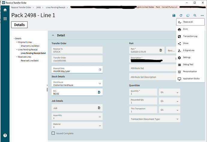

I ask because that is the behavior that we had with the Classic version, but since switching to the Kinetic version that seems to have gone away. Even the prompt for receiving the lines is labeled “Receive All.”

@SueLowden I’d love to see some screenshots of how you accomplish this in Kinetic, because I see nowhere that the receiving location can uncheck/choose not to receive a specific pending line of a Pack, delete a pending line, or even alter quantities on those lines prior to clicking the “Receive All” action.

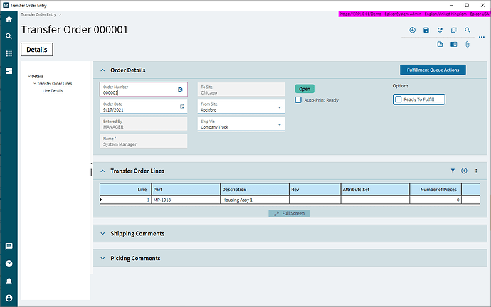

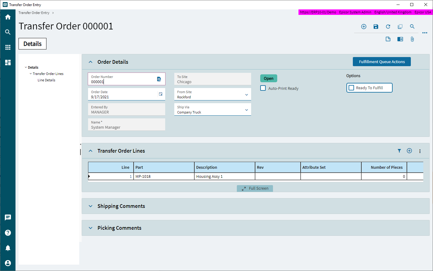

I can see a suggestion in the demo system for 10 x parts to be shipped from Rockford from Chicago:

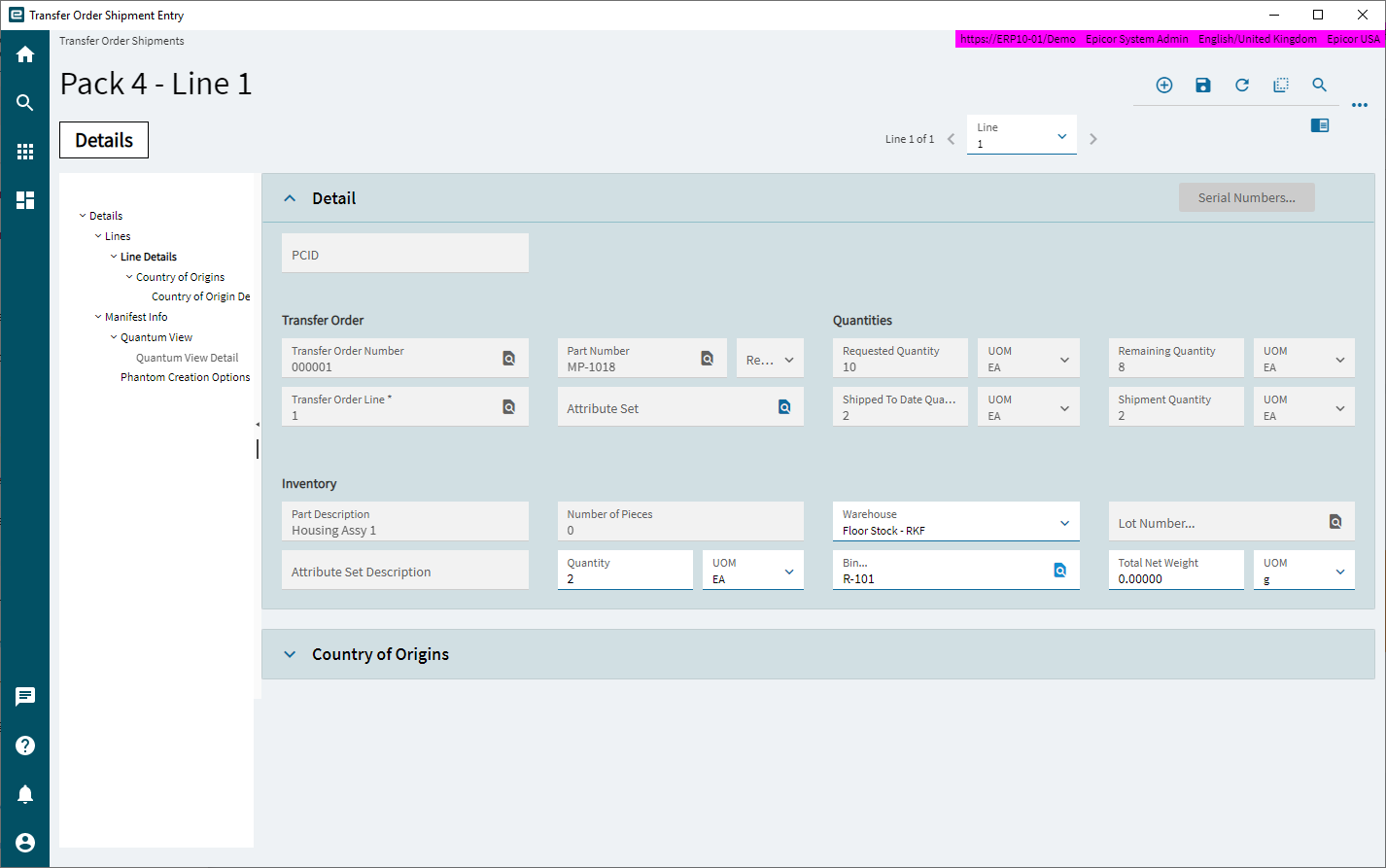

Then i can add a Transfer Order Shipment for any quantity against the Transfer Order (in this case 2 have been shipped from site a to site b)
And later i can ship part/all of the remaining quantity

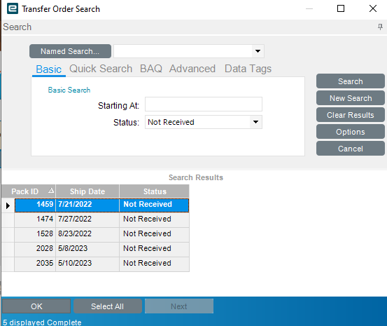

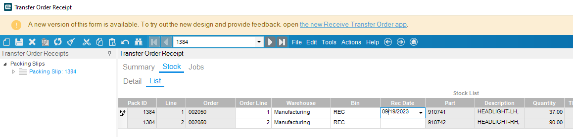

Here’s an open pack:

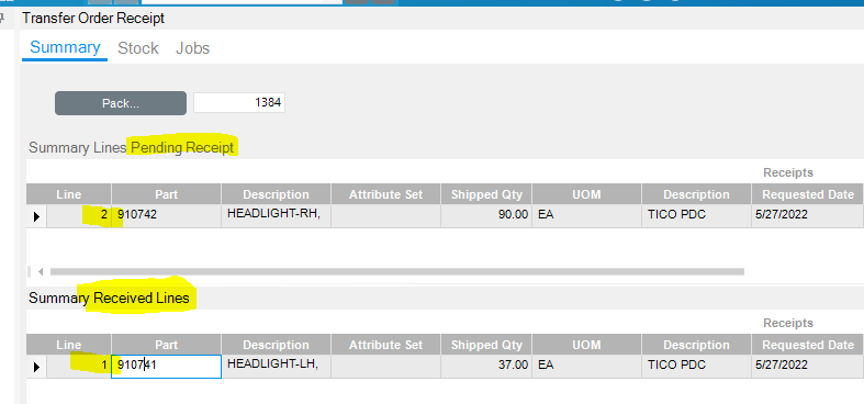

I’ll put a date in line 1:
And it receives only the one:
I mean, you said prior to “Receive All,” and OK, no, I didn’t do Receive All. And I didn’t change the quantity.

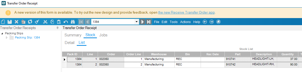

What’s also terrible is that it looks like pack 1384 has nothing left to receive now:
Seems like we could play off that glitch and make it work one way or another. Ha!
