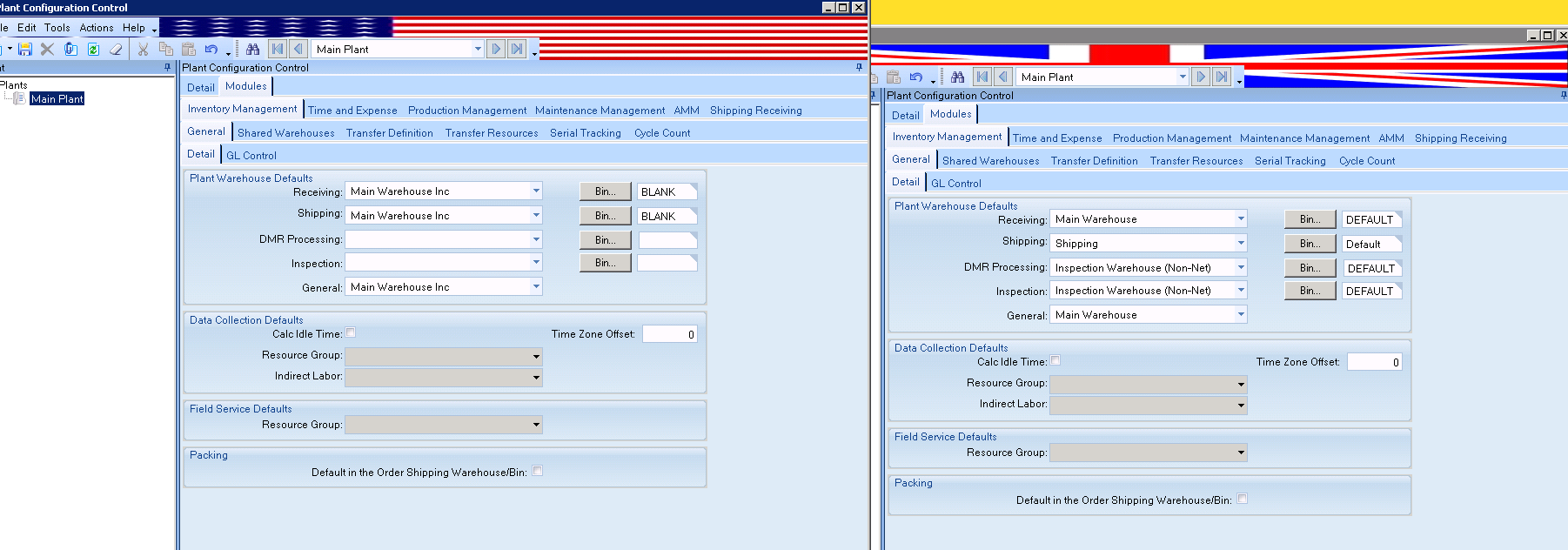

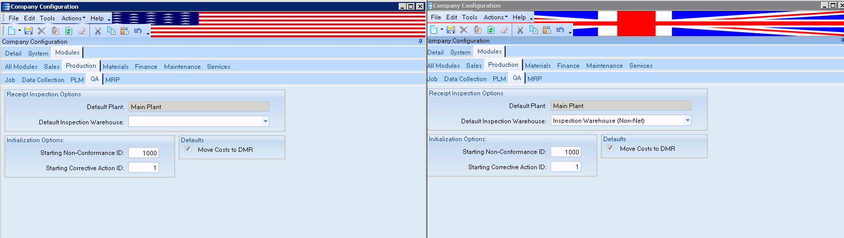

Your right - the table RCVDTL shows the transactions in question.
In terms of the warehouse setup…the company on the left of the screenshot is the one with the problems…(as you can see the warehouse is blank)
:+1:
so, are we saying…
  1. select a default warehouse and then monitor it from hereon.
