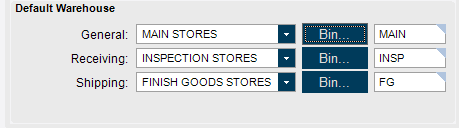

Hey @Rowley150, i think, the company configuration has the setup for Default warehouses.While receipt entry,your receiving bin was definitely selected as inspection bin,no matter "Inspection required " was unticked.Co-incidently ,i have found the similar issue at today morning.
Please recheck in the test, whether it is selecting “INSPECTION” Bin while receiving the “No inspection required” material.
