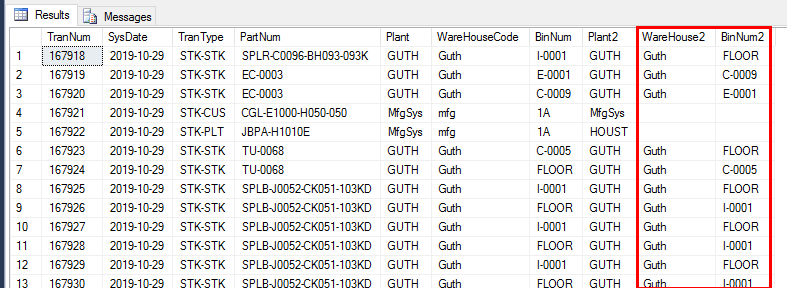

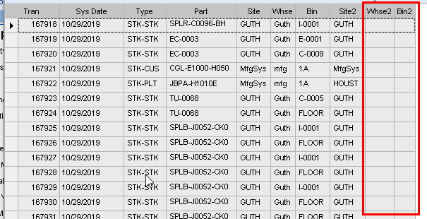

The Results of a BAQ:
A query in SSMS shows:
A Trace of the BAQ being tested shows two interesting entries:
<QueryFieldAttribute>
<Company>MC</Company>
<QueryID>E10-PartTran-Bin2</QueryID>
<SubQueryID>a9d90e9b-b3e9-45ae-8a56-513b5179e77c</SubQueryID>
<TableID>PartTran</TableID>
<FieldName>WareHouse2</FieldName>
<AttributeName>Caption</AttributeName>
<Value>Whse2</Value>
<SystemFlag>false</SystemFlag>
<SysRevID>0</SysRevID>
<SysRowID>43556d1e-ef3d-4d08-a03f-9732fb91e77c</SysRowID>
<IsOverriden>true</IsOverriden>
<BitFlag>0</BitFlag>
<RowMod>A</RowMod>
</QueryFieldAttribute>
<FieldName>BinNum2</FieldName>
<Value>Bin2</Value>
<SysRowID>b1ddde39-af54-4721-9aa4-a756f692e77c</SysRowID>
<RowMod>A</RowMod>
Specifically, the <IsOverriden>true</IsOverriden> entries.
Also, the <QueryFieldAttribute> nodes only exist for Warehouse2 and Bin2.
