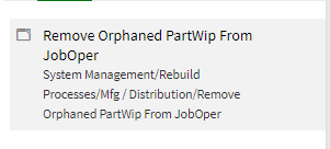

Although I was just looking at the processes and saw this one. I’ve never used it before but it almost sounds like it for these scenarios. Maybe worth testing in PILOT or if someone else on here has tried it before has any experience with it.
