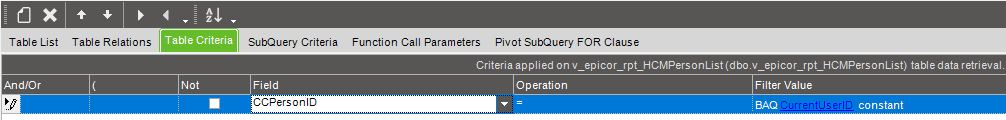

Do you have the user id as a column in your view? If so, you can just add a table criteria in the External BAQ query builder for Field: DcdUserID = BAQ special constant (CurrentUserID)
Here’s an example where I’ve done this:
This should filter the query prior to instantiation.

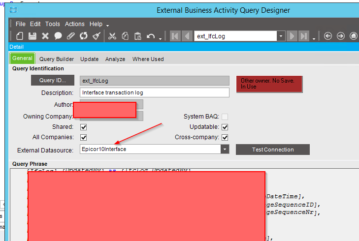

You can add the current user to the External BAQ Like this
Add Calculated Field
Add Constant
Display Current User in BAQ
Or you can Filter by Current User
