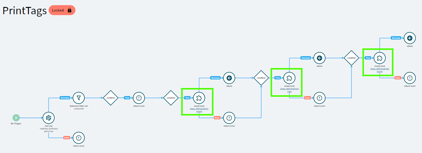

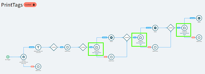

The “Print Tags” event in “EndActivity” is pretty big:
Depending on the tags you want to send data for… you may have to repeat this process. (3) of them highlighted in the above snip.

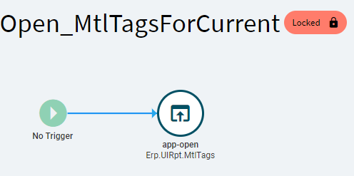

For example the Open_MtlTagsForCurrent event:

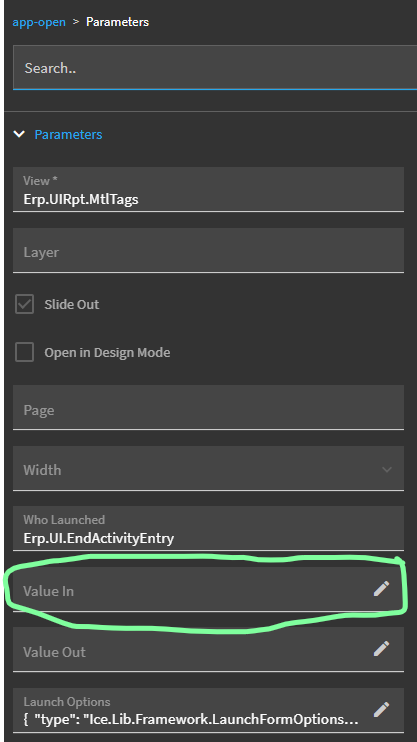

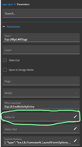

This is where the program is going to “app-open” the MtlTags report slideout.
You’ll need to include the data your passing in the “Value In” JSON:
