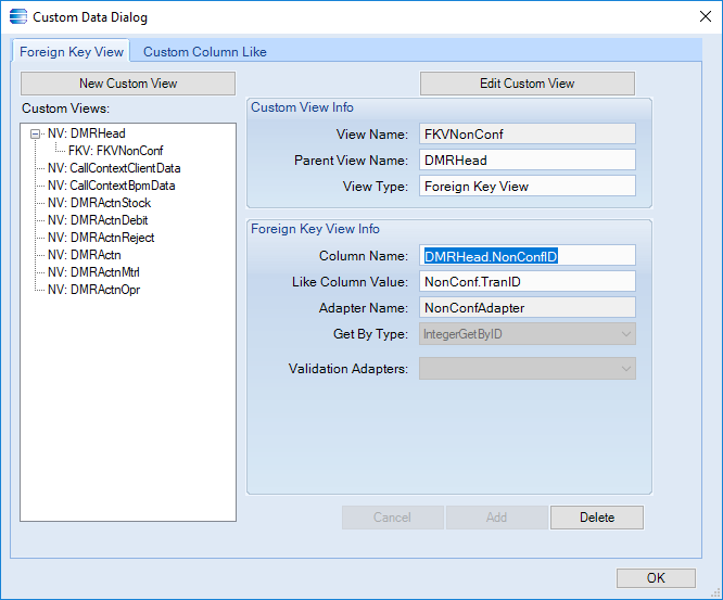

In the past, the way I’ve done it, is in the Customization Tools Dialog you can click on Tools - Data Tools and add a New Custom View (Foreign Key View) and connect the DMRHead table to the NonConf table through the NonConfID Column and Adapter:
Then when you go into the EpiBinding list you should see your FKV and the fields associated with that table:
I hope that helps! Maybe there is a better way to do this but this is what has worked for us.

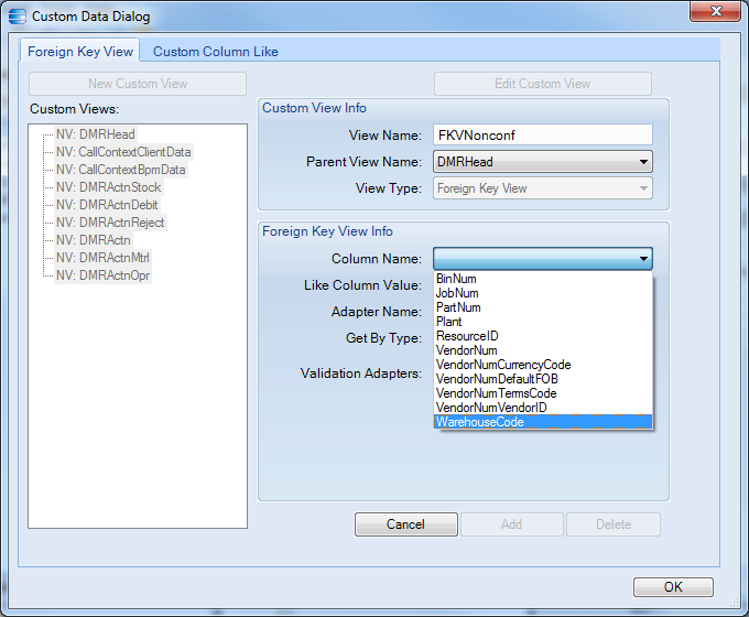

Thanks for the suggestion. Unfortunately when I try this I get a drop down in the column name and NonConfID is not an option. I don’t know why I can’t type in that field.
Melissa

Just to see if a little more detail helps…I’m in the DMR Processing Form.
And in the Custom Data Dialog window, I selected DMRHead in the Parent View Name dropdown list. Foreign Key View gets automatically populated in the View Type field.

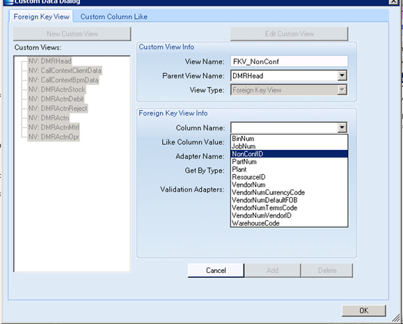

Then it gives me the Column Name list dropdown with the NonConfID option:
Could you post a print screen of the list you are seeing?
That is so strange. I have the exact same list except for NonConfID…
I am running 9.05.603, should I ask Epicor about that?
Melissa
Did you make sure NV: DMRHead was selected in the left pane before clicking New Custom View? These options look like DMRActnOpr was selected in the left pane.
Hum…that is very strange indeed. I just tried highlighting each item in the left Custom Views pane before pressing the New Custom View button in my .702 environment and they all gave me the NonConfID BUT what @danbedwards suggested is definitely worth a try (making sure you click and highlight the DMRHead in the left pane before you click New Custom View button) because I swear I have seen it behave that way before and not give you the same drop-down list depending on what you select/highlight in that left pane.
