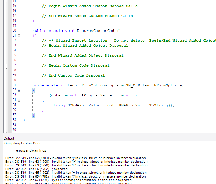

Okay, I tried that. Attached is a pic of my errors.
Add the form load event and then you can use code like this within it…
	private static void RMAProcForm_Load(object sender, EventArgs args)
		// Add Event Handler Code
		LaunchFormOptions opts = RMAProcForm.LaunchFormOptions;
	    if (opts != null && opts.ValueIn != null)
	    	string value = opts.ValueIn.ToString();
			MessageBox.Show(value);
