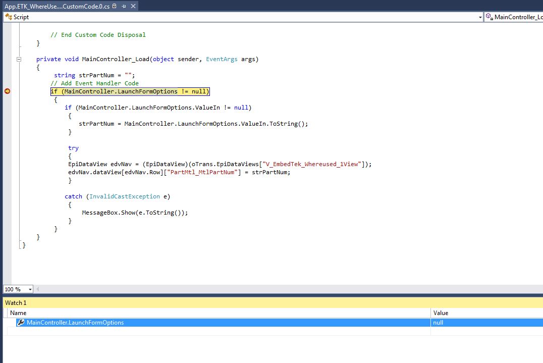

How do you get the value to appear? The controller doesn’t have the field?
Never mind. I recreated the dashboard and now it works. Wonder if it has something to do with this one being uplifted from 9.05.
who knows but it works now.
