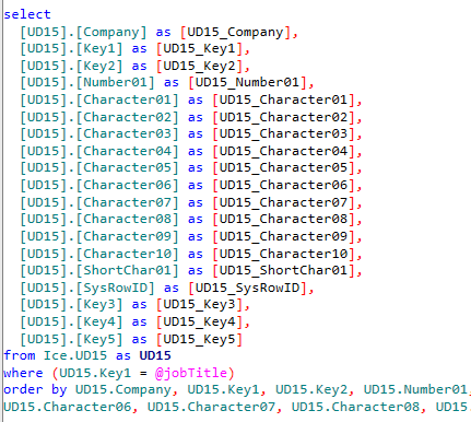

this is the SQL used to fetch it…
and this is the table criteria (when I manually do it, a form appears which allows me to enter the ‘jobTitle’ param → this works fine and returns me the rows I expect).
