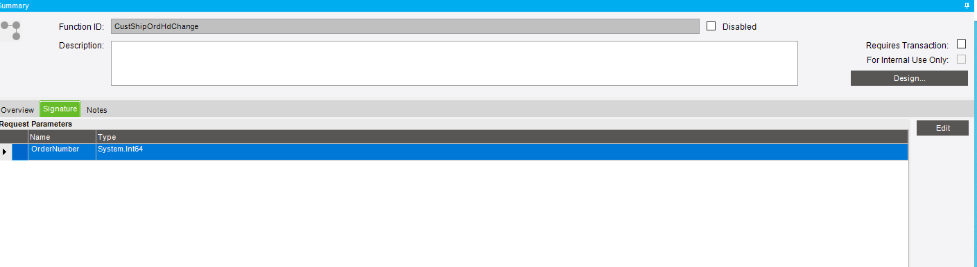

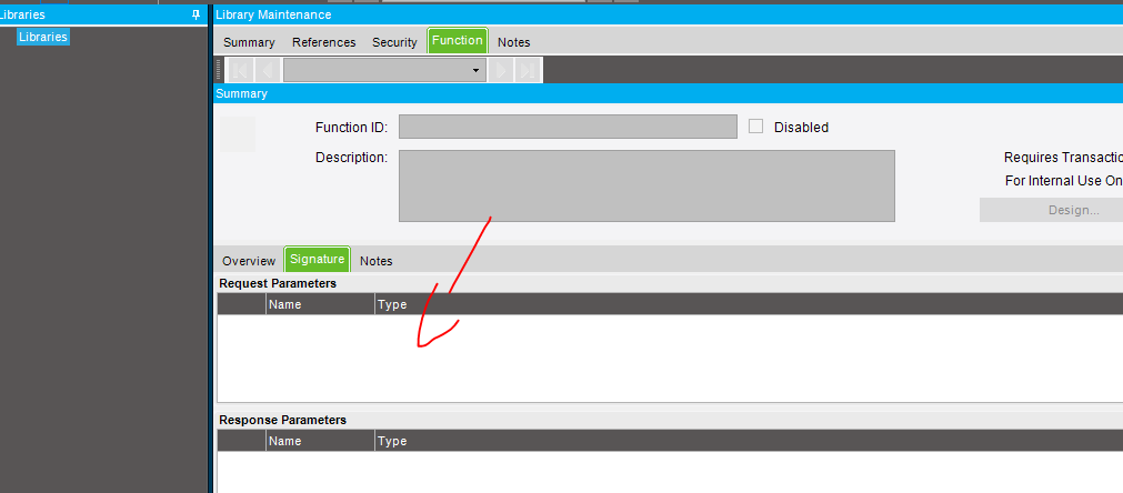

You have to define them in Function Signature → request Parameters:
I’ve been setting them as Int, do I need to set them up as something else? Sorry for all the questions, this is the first time I have used functions, so still earning. This is the one area I am really fuzzy on, connecting the function to the parameter.

So, I have a BPM that has the ordernum, packnum, and custnum I need to pass to the function. I have created the parameters in the signature but the function still isn’t picking them up. Trying to figure out where I went wrong and why it isn’t picking them up.

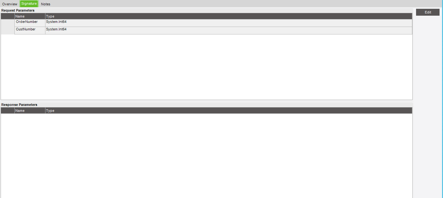

What does your function signature look like?
Is it one input parameter that you pass multiple values to using a tuple?
Or what?
Really just need the Order Number to do what I need to do correctly.
Yeah so now you call the function in your bpm custom code:
this.InvokeFunction(“LIBRARY”,“FUNCTION”, OrderNumber, CustNumber);
Make sure both parameters you are passing (OrderNumber and CustNumber) are int.

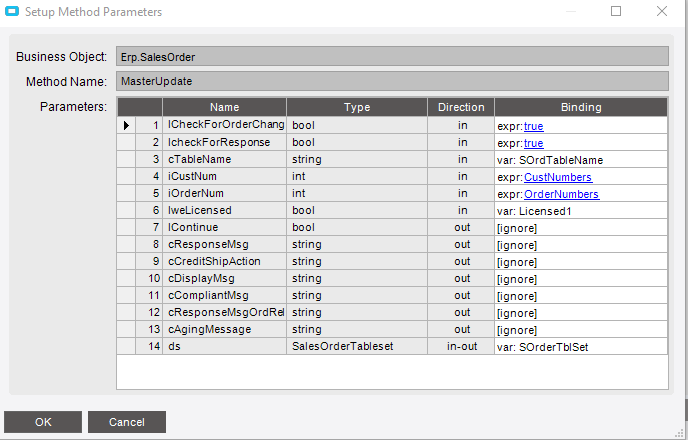

It is set up where the BPM sends the parameters to BPMPickup Function that is using CustShip, and that sends the parameters to OrderFieldChange which is using SalesOrder.MAsterUpdate.

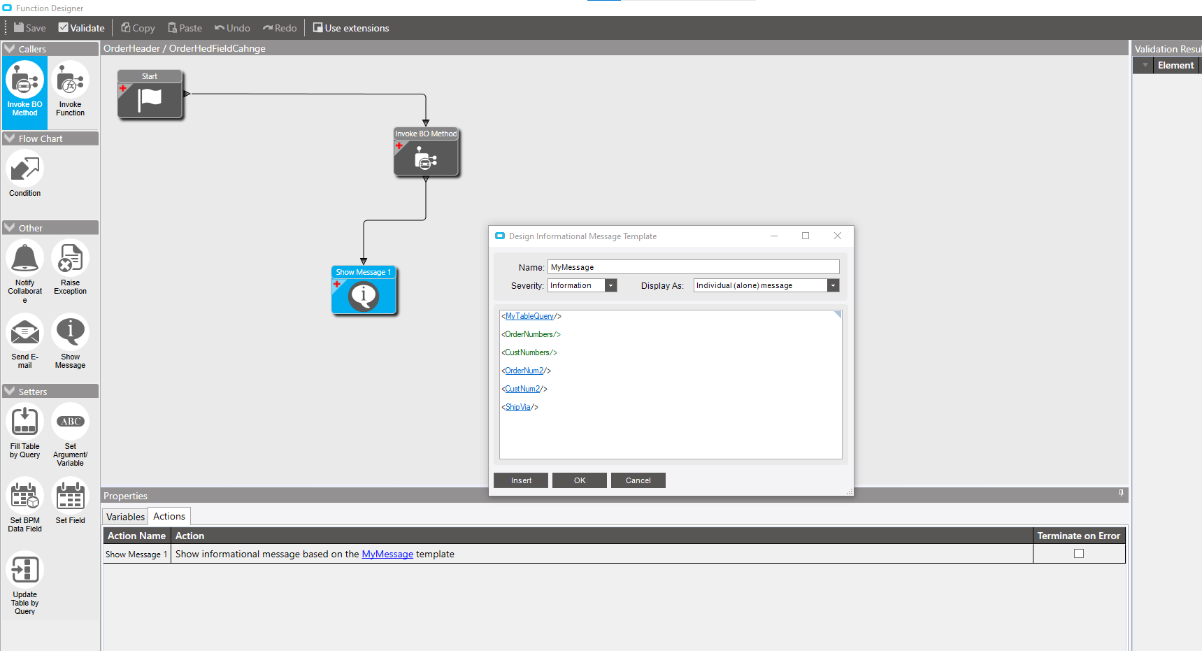

Here is how it is setup:
Will my friend, what do you mean the OrderHed table isn’t populating any info in it?
The green are from the parameters. The blue are me trying to get info form the Order table itself.

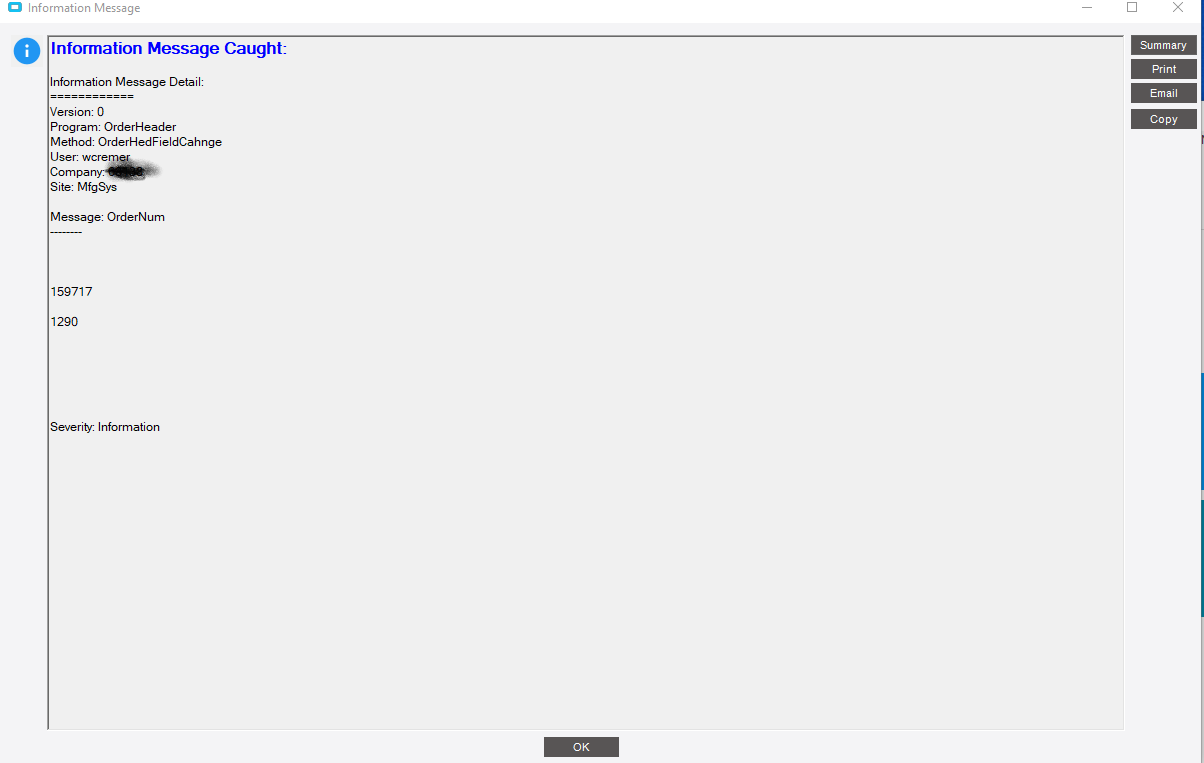

When I run the bpm, I get this:
Only the Parameters actually show up, the others I am trying to get form the OrderHed table are not coming through.
Why are you calling master update to get the dataset for an order?
Try GetByID and pass the ordernumber.
