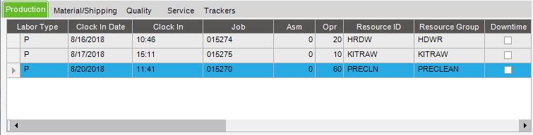

What I am trying to do is pass the select Job/Asm/Opr to a BAQ report as option fields. Normally when one starts a job from MES, the row they have selected in the LaborDetails grid will determine which Job/Asm/Opr they clock on to. I would imagine that I need add the BAQ report form to MES as a button, and then have some sort of customization in MES so that when that the button is clicked, it picks up the information, and passes in to a customized BAQ report that fills the fields accordingly.
Is the LaborDetails grid accessible as a DataView?

Thank you! I have set up LFO in the past, so I should be able to do that. I guess my question is, how do I determine what the DataView I need to reference is? For example, I have a DataView on a customization for Start Production, which is called “Start”. I find that out from someone on this forum, but otherwise how would I know what the DataView is called, and what the field names are?
Update: I checked out the EpiBinding for the grid, and it says LaborDtl. So I used that, and I can pull a field from the DataView!
