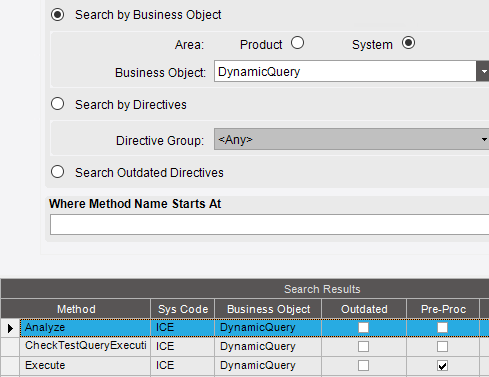

Maybe… however I dn’t know that there’s a BPM intercept in the Dashboard excution point… Maybe ExecuteQuery? But by then it would have already prompted you for the params… (Me thinks… I haven’t tested this)
I was looking at the ice.dynamicquery business object and execute method.
It looks like there is a BPM intercept in the trace log.

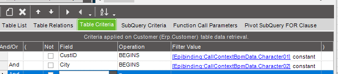

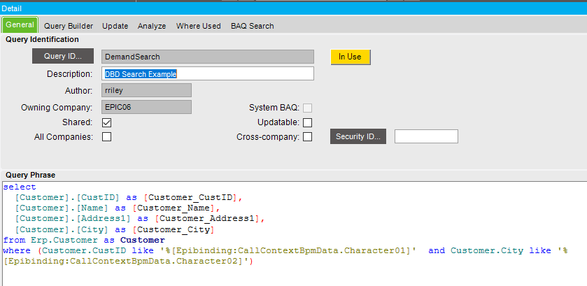

BAQ called “DemandSearch” created against the Customer table with BAQ Markup applied in the Table Criteria against the CustID and City columns (not particularly useful except for as a simple example)
On the “Table Criteria” Sheet of the BAQ Designer, create two criteria lines:
Field: “CustID” Operation: “Begins” Filter value: “specified Constant” for the specified part enter: [Epibinding: CallContextBpmData.Character01]
And
Field: “City” Operation: “Begins” Filter value: “specified Constant” for the specified part enter: [Epibinding: CallContextBpmData.Character02]
An image of my sample BAQ is below.
DBD created with DemandSearch BAQ. Tracker Panel added - No Fields set as Prompt
DBD AppBuilt and added to menu
Run DBD from Menu in Customization Mode. Customize:
Add TextBox control for CustID filter – bind to CallContextBpmData.Character01
Add TextBox control for City filter – bind to CallContextBpmData.Character02

If there is no data in the Markup Referenced field, the Markup itself is sent as the Where Clause Criteria – clearly not useful…
You cannot Test Markup in the BAQ Designer - it just executes the BAQ with the Markup as the criteria. Test your BAQ without Markup and when happy, add the Markup criteria.

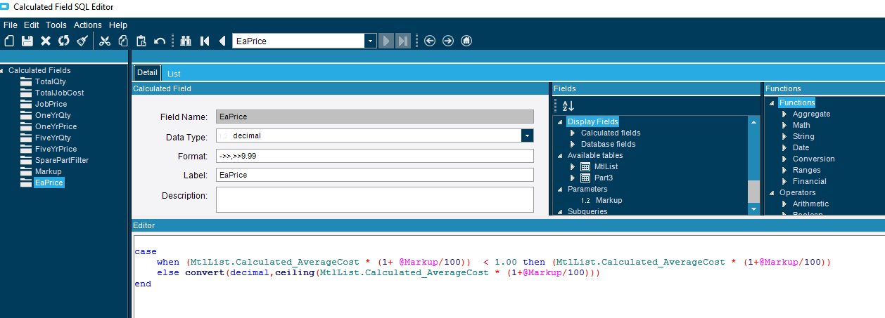

This will be a perfect solution for a use case where I need to calculate a markup percentage. Currently I do it with parameters. I can make a text box that always has a number in it. Nice!
Edit: had to think for a second, that’s only filters. Can I use the same technique to pass in a value to a calculated field?
If you are configuring the Parameter on the Table Criteria section, you can use the Markup feature instead - instead of using the “specified Parameter” option use the “specified Constant” and configure the value as the Markup.
TableCriterria
But can I use it in a calculated field? That’s what I’m wondering.
I have spent the morning testing this using the BAQ Markup and it works fine given the above example. However, I need to do this on a Date field. I have added two EpiDateTimeEditor fields and bound them to CallContextBpmData.Date01 and Date02. My Table Criteria are
This returns no results, looking at SQL Profiler it looks like the BAQ Markup inserted the date but did not put quotes around the date.
’ where [SalesDetail].[ShipDate] >= 2018-07-01 12:00:00 AM And [SalesDetail].[ShipDate] <= 2018-07-31 12:00:00 AM ’
Any ideas?
