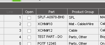

For example, I copied the selected area of an excel file, for Paste Insert to Order Entry.
Note that the Line numbers are dups of existing lines. They are ignored.
Copying:
And Paste Intert into:
yields:
If I try to paste just
I get:
Note that the Description value - the 3rd column of my clipboard data - tried to paste to the Part filed in the grid
FWIW -
  • I usually re-order the grid columns putting just the ones I need to update on the left side (first to be pasted in each record).
  • Some grids will do a lookup and update a field when another changes. So make sure the order is correct, if you do or don’t want to overwrite the retrieved value.
    • For example, when the part description is retrieved from the part table. Upon pasting the partnum in its cell, the description field’s cell is automatically populated. If the description column is in the range your clipboard data spans, it will get overwritten.
  • Some grids display the description of a code based field instead of the code. But you need to past the code.
    • ProdGrp is an example. While the grid shows PrdGrps as:
      You’d need to have the data you copy as:
