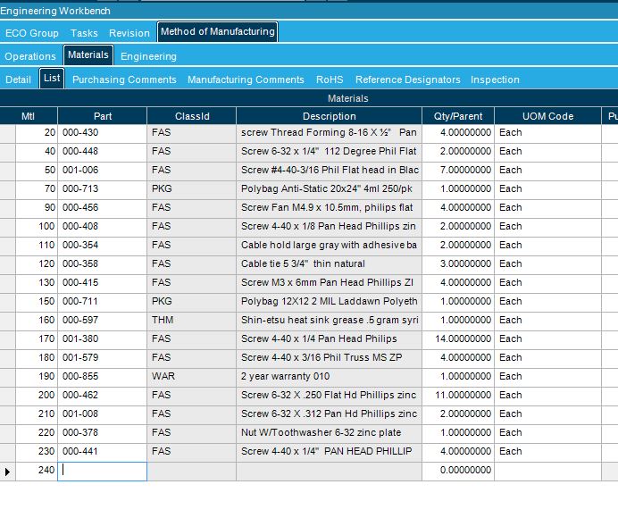

I have been playing around for an hour or so trying to get this to work. Do I just copy and Paste the whole table? The same Business Logic Error keeps popping up before the UOM can be added.
I can add the part manually, but that is not ideal when there are 150 parts to add. I was going to go the DMT route, but would like the users to be able to do this on their own if possible.
Interesting the column says UOM Code but it appears its a UOM Description being displayed (potentially). Have you verified that Each is in fact a valid UOM CODE?
