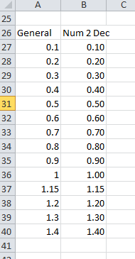

When I paste it into excel, it seems to take the correct number of decimals, but if the 2 decimal value has a trailing 0 then it cuts it off by default, and the user has to set excel to display 2 decimals.
Is there a way to force the correct number of decimals so that no matter what, they are correct? Should I just convert it to strings for more control?

Actually i’m looking at it wrong. If you convert to text within excel and save the report it will flow with however many decimals you have in the text since it’s just a string.
When you re-open it, it will remove all trailing zeroes.

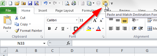

You don’t even need that part, if the whole column is already formatted, it seems to keep it when you paste using control V.
The column with 0 decimals works fine, I think I’ll just have the user change the formatting on the column that needs 2 before she does a save as to CSV. (Or I’ll get bored and code the export so I can control the formatting better than using excel)
