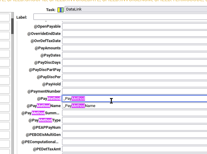

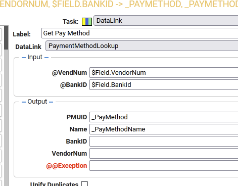

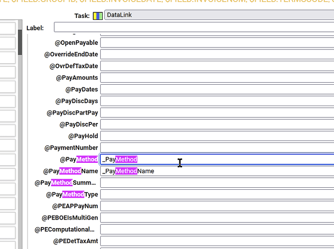

So I though, Ok, I’ll set in on the create invoice datalink and set it explicitly, since there are spots to set it.
I’m getting that from a datalink SQL call. That part is pulling the correct information.
Well, that doesn’t seem to be working, and I don’t know what I’m missing.

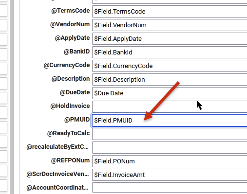

I figured out what it was. :man_facepalming: . I was looking at the wrong field. It’s PMUID. Once I set that, it’s good. Information overload.
