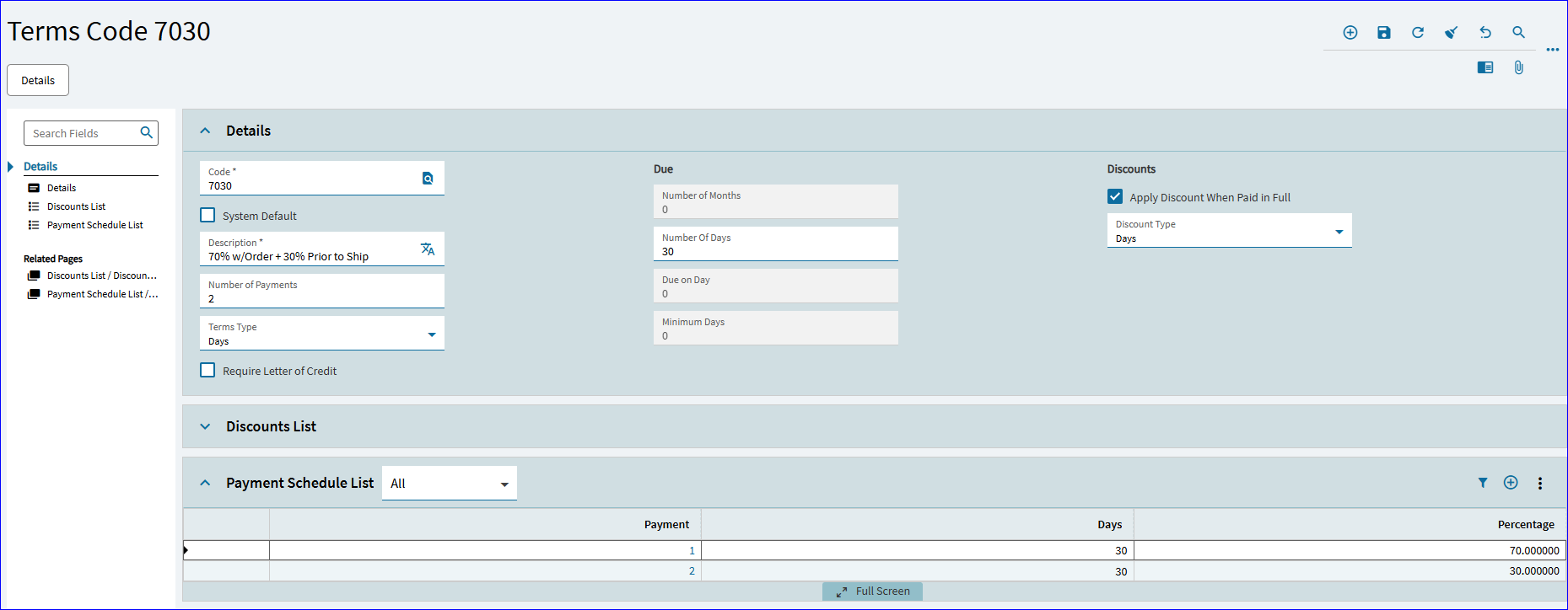

This is how I set ours up for a 70/30 payment:
I set the number of payments to (2).
The Number of Days gets a little confusing. I’m not sure of the logic. I’ve found it easier to leave the main setting at 0, then add Days to the Payment Schedule.
So, I then added two payments to the Payment Schedule List.
The first is for 70% due in (0) days from invoice.
The second is for 30% due in (30) days from invoice.
I never get any feedback from our accounting side, so, I’m not sure if this works as intended, or if they see odd things and don’t know why. But they haven’t complained (yet).
Hi! This could be worth testing in Pilot: thank you for the hint!
