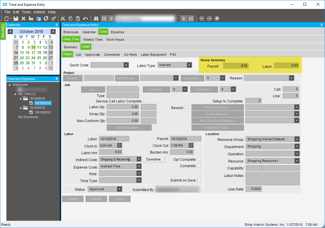

Can anyone explain to me why there’s a 0.01 difference between the labor and payroll hours for this employee?
Do you have any payroll rounding rules? We consistently have Payroll different than Production Hours due to this. The fact you are seeing it on just one transaction is a little odd. Perhaps the Grace Period rounding sees it differently than 49/60 = 0.81666666666 ?

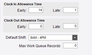

We are running “External Payroll Integration” which is an Epicor module (not the standard Payroll one you are running) and there is “External Payroll Class Maintenance”. Here is the screenshot:
Unfortunately I can’t speak to Epicor’s Payroll.
We have some clock in/out allowances, but it doesn’t seem to be close to those.v
That’s weird then. Are there other records that are a minute off or just this one?
This is the only one that we’ve found this week that has had a discrepancy we couldn’t explain.
